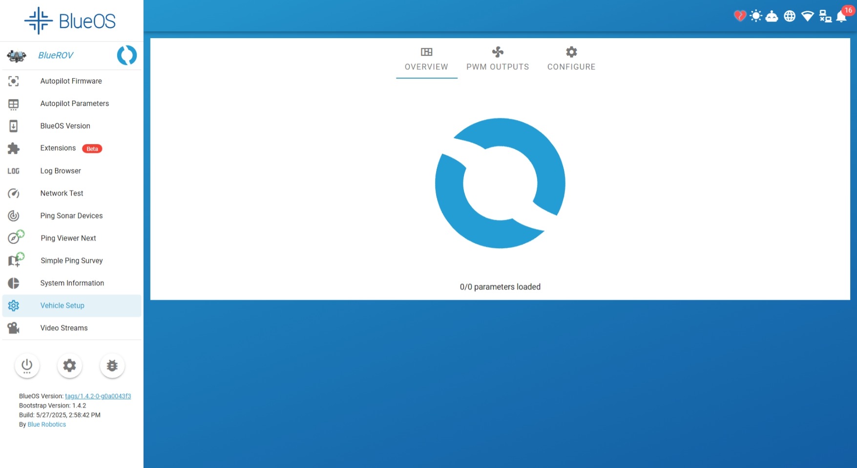

Thanks for that. I’ve attempted to adjust the parameters. None of the values suggested (actuator, lights ) exist in the list of options. I’ve attempted to reload 4.5.5 and bluerov heavy parameters into Blueos. Now when i enter Vehicle setup i get a message that 0/0 parameters are loaded, and no parameters are set in Autopilot.
Hi @cam1 -
You’ll need to enter in the numerical value (in parenthesis) under autopilot parameters, for the parameters Eliot listed. You may need to click force as Eliot mentioned!
If no parameters load at all, try restarting the autopilot from the power button in the lower left of BlueOS….
