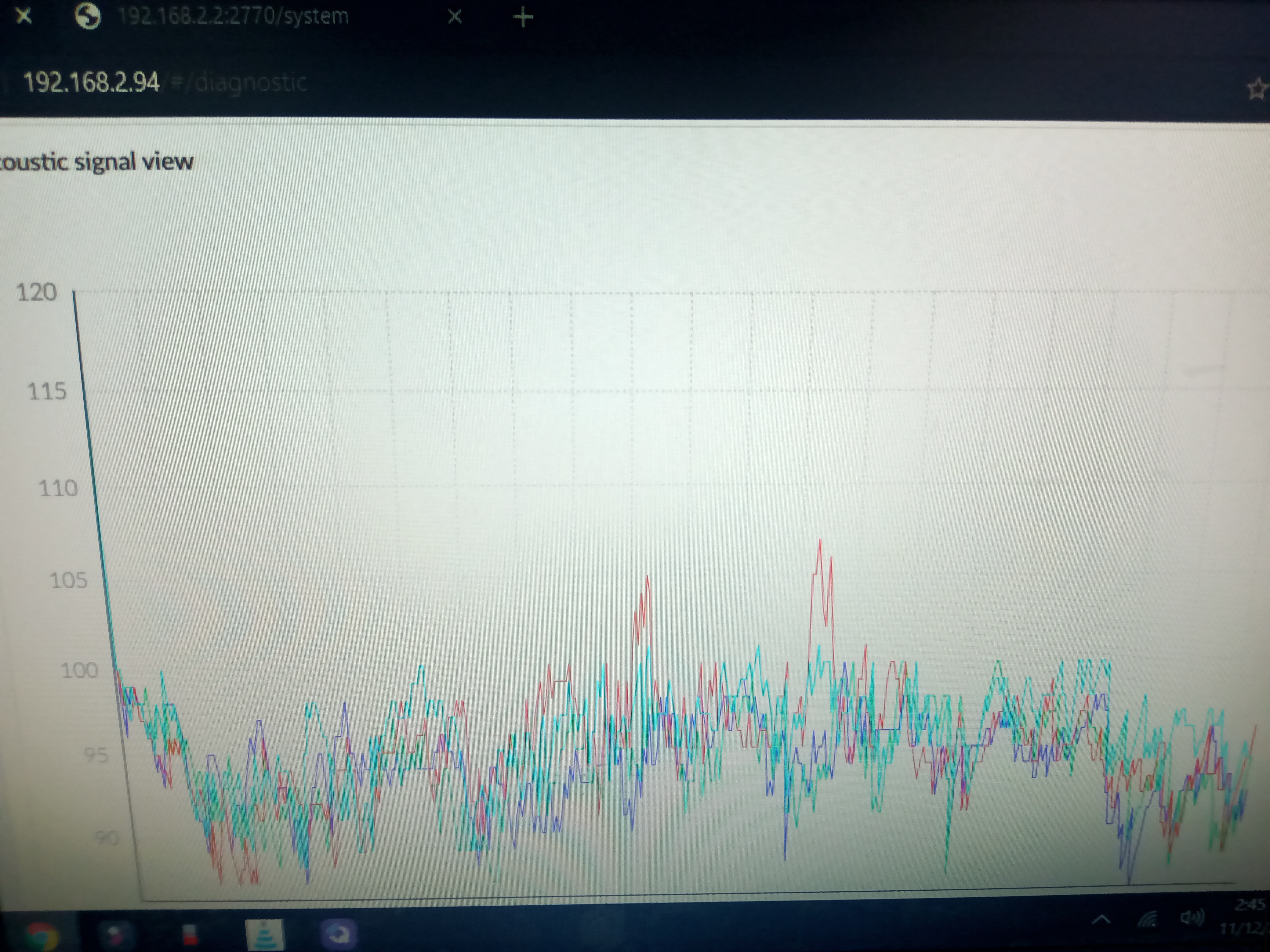

Post your diagnostic picture:
https://waterlinked.github.io/docs/underwater-gps/gui/diagnostic/
The diagnostic page shows noise signals from all receivers and when I put locator near to any receiver it shows peaks from that receiver and no response from other receivers.
I will share the picture by tomorrow.
Dear Bo,
Please find the pictures of the diagnostic page attached below.
When the locator is in contact with any receiver there is no peak but when it is close to any receiver it shows abrupt peaks from respective receiver.
