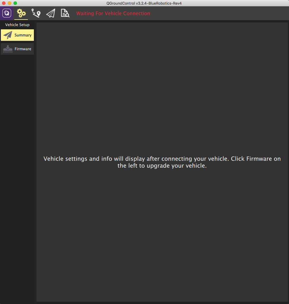

When I open QGroundControl I get the following:

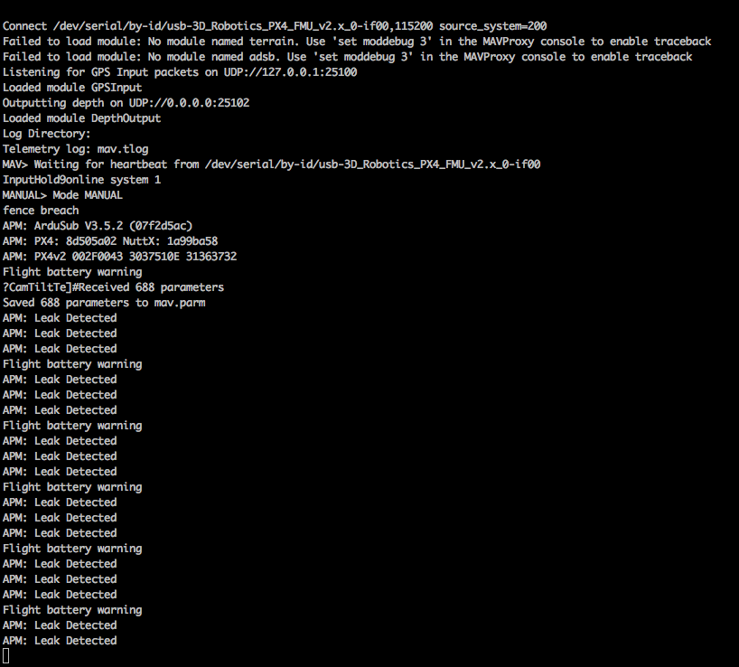

I followed the Troubleshoot section and got the following output when I did:
$ screen -r mavproxy
