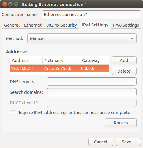

With Windows 10 (Home PC), my Rov is responding perfectly! But from a Ubuntu 14.4 ground station (Laptop), the same Rov just sends video, but is unable to make the vehicle connection!?
One question is that I’m unable to change the netmask in the IPv4 Settings… Could this be the cause of my problem?
What is your netmask, can you post a screenshot? I don’t know why you would not be able to change this. To change them, click the numbers under the ‘Netmask’ column.
Here are my settings:

This was my problem and I found out how to change it in modifying the /etc/network/interfaces file.
And now it is working great !!!
