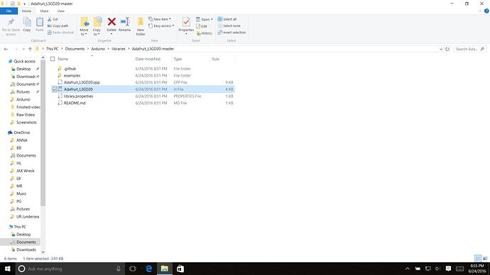

I am trying to implement the adafruit L3GD20 gyro into my ROV heading hold Arduino program. Although I have downloaded and unzipped the “master” from GitHub into the library, it does not show up on the library list in the IDE, so it won’t compile. I have attached a screen shot of what my Arduino directory looks like. I had the same problem with the LSM303, which I finally solved, but can’t remember how.

Okay, I solved it. You have to let the Arduino IDE zip library unzip the master file. If you open the downloaded master file and unzip it into the Arduino library directory it won’t show up in the IDE. Crazy, but that’s the way it is.
