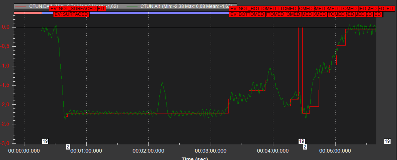

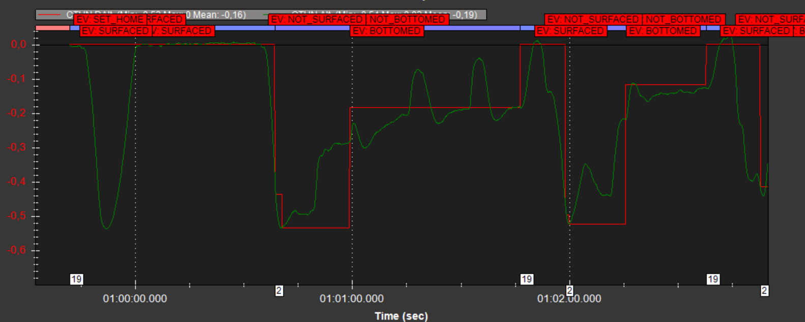

But after analyzing the logs, it seems that this behavior is due to the ROV detecting that it’s either at the surface or at the bottom.
(in red : CTUN.DAlt - desired altitude, in green : CTUN.Alt - altitude)
