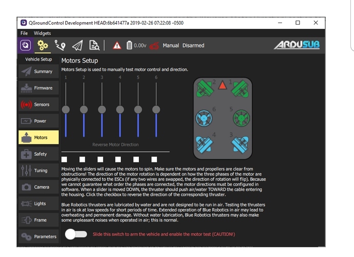

Thank you for the response. I’m understanding that the calibration setup menu is this one, correct?
That is correct. Make sure the air flows the same way as the water should do during operation. Lets hear about the result.
I’ve just checked the configuration again and it is correct. Pushing the lever down, the ROV dives deeper into the water. Motors 1,2 and 5 are “reversed” so that everything works fine.
