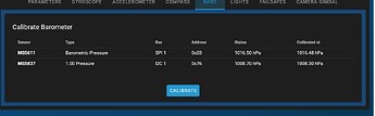

At the same time, it seems like if it was detected in BlueOS (see image). Why this different behaviour?

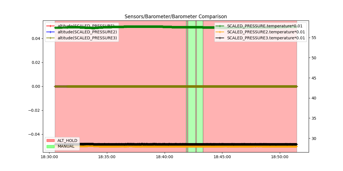

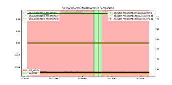

Even when I see depth sensor data in the overlay, it’s not recorded in the telemetry files (see image).

My main question is: why am I able to see depth data and use “Depth Hold” mode, but not receive altitude (SCALED_PRESSURE2) information? We need both the depth information and this flying mode for our surveys.
