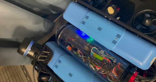

1.Software version (Ardusub 4.1.0, QGC 4.2.3 (try other version ex.4.1.~), Companion 0.0.31)
2.attached video
