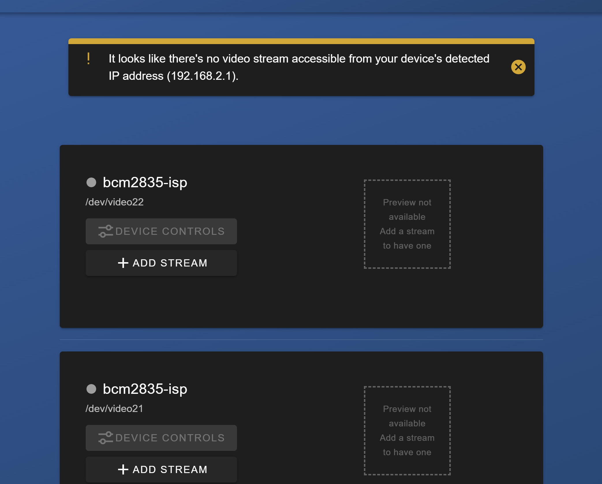

There is a lot on the page so hard to get everything, but here is a screenshot that includes the only preview that is displayed.
Cool. This screenshot is fine.

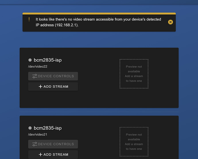

No streams and error message reads:
It looks like there’s no video stream accessible from your device’s detected IP address (192.168.2.1).
How do I configure the streams ?
Thank you in advance sorry for my lack of knowledge.
Hi @grahammalyon -
No problem. If you scroll down on the video streams page, you should be able to add a stream for the /dev/video2 device (H264 ,1080p, 30fps, and UDP should be fine.)
Once you’ve setup the video stream, both QGroundControl and Cockpit ground control stations should connect and let you see the live video stream.
Definitely checkout the operators guide to get started.

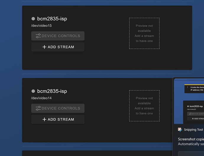

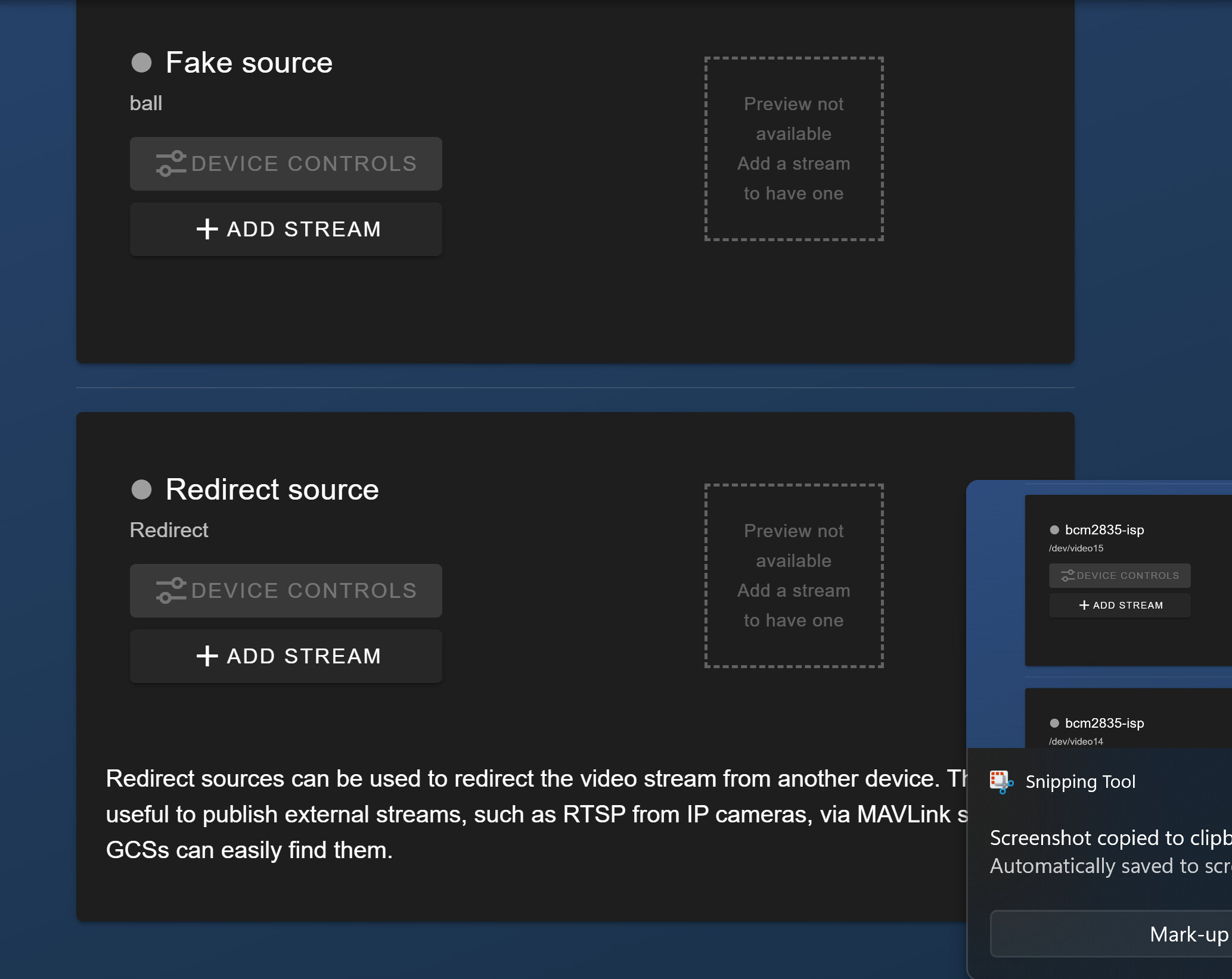

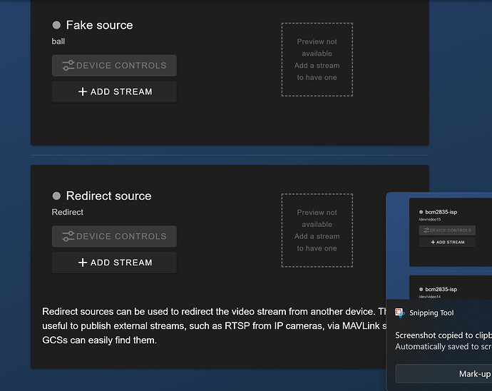

Hi Tony I don’t have the /dev/video2 device option listed the H264 was an option but its disappeared attached are the options I see. Thank you for your help.
