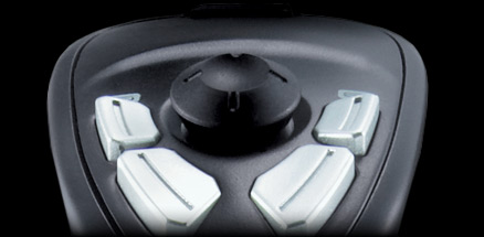

hi
This product you introduced
I think you can do all the gestures
8-way hat switch
Put your thumb to work
Quickly and easily switch from points of view to weapons and more—the 8-way hat switch is designed to accurately capture specialized input specific to flight sims.
ascend / descend : It can be done by this section
The hat identifies as a ‘button’, you need an ‘axis’ for ascend/descend.
