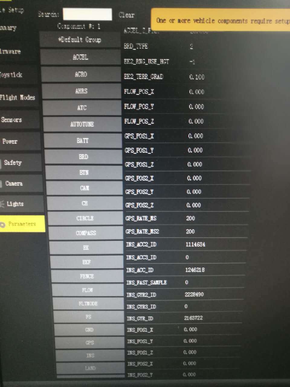

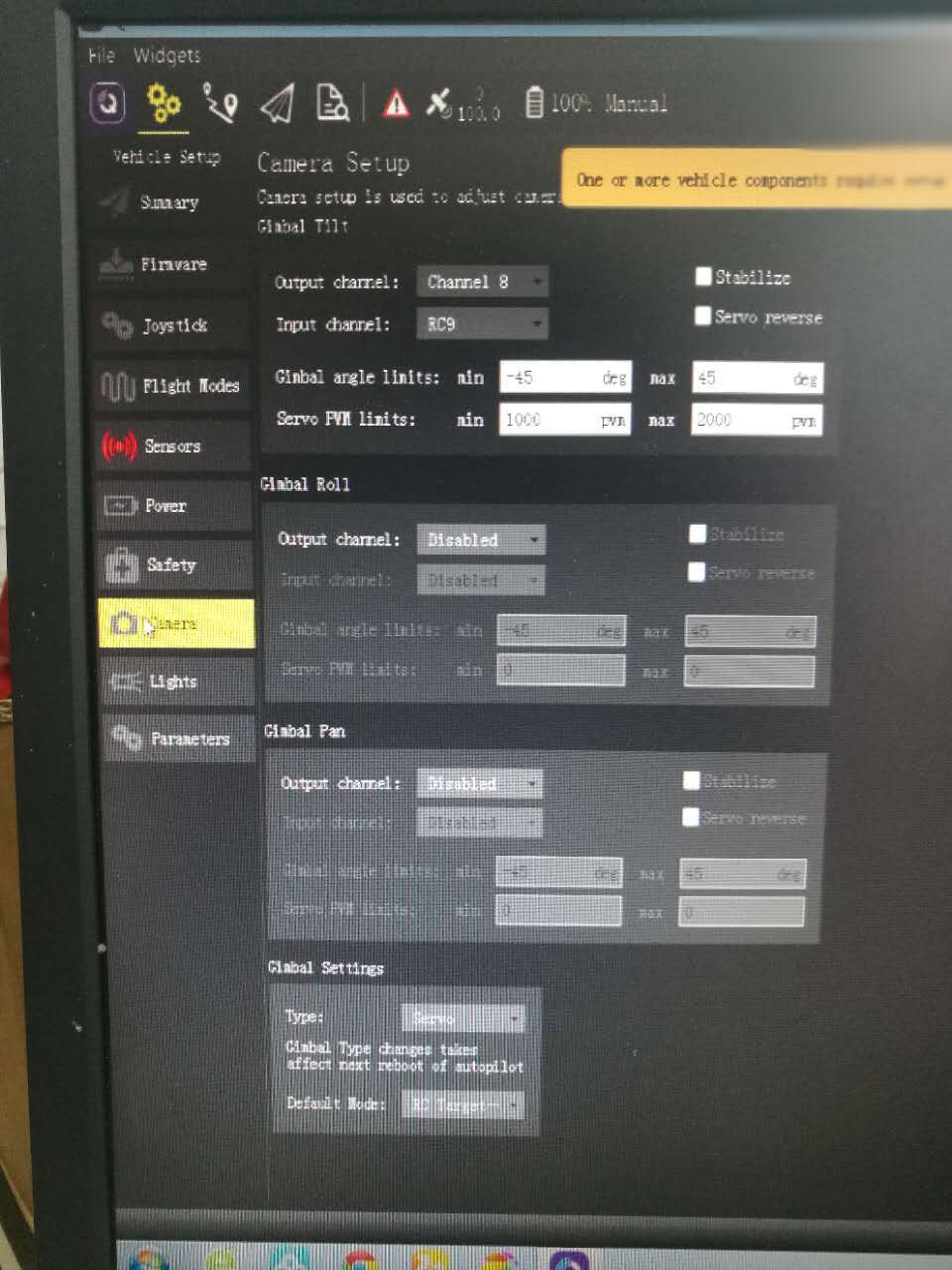

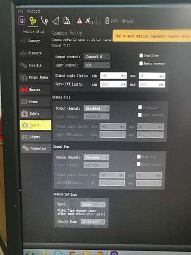

I have almost finished the BlueROV2 assembly work and a strange phenomenon was found in the test. The camera servo is synchronized with the action of the lumen light. That means if I press the button to increase the brightness of light, the camera servo will rotate at the same time. If I decrease the brightness, the camera servo will rotate versely. If I remove the sigle yellow line of lumen light from the Pixhawk, the servo will never rotate again. I have checked the wires of lumen light and camera servo and they are correct. The OS is WINDOWS 7 and the control pad is XBOX game pad. The following pictures are screenshots about wires, joystick, camera and parameters. What should I do? Thank you for your attention.
Please set the ‘Input Channel’ on the Gimbal Tilt to RC8.

Thank you very much, It works.
