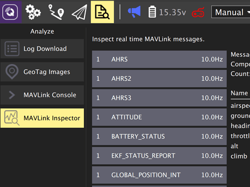

Note that QGroundControl has a MAVLink Inspector tab where you can check the current frequencies of any and all mavlink message types being sent to the top computer.
