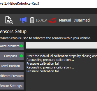

Try to calibrate the pressure sensor but got failed once and once again. Anyone else have experienced this issu?
calibration fail
QGC and Ardusub both updated to latest version.
Do you have a pressure sensor connected? Are you able to switch to depth hold mode?
It will fail if the autopilot does not detect a pressure sensor connected at boot. This can be caused by poor connection to the pressure sensor, or damaged hardware.
