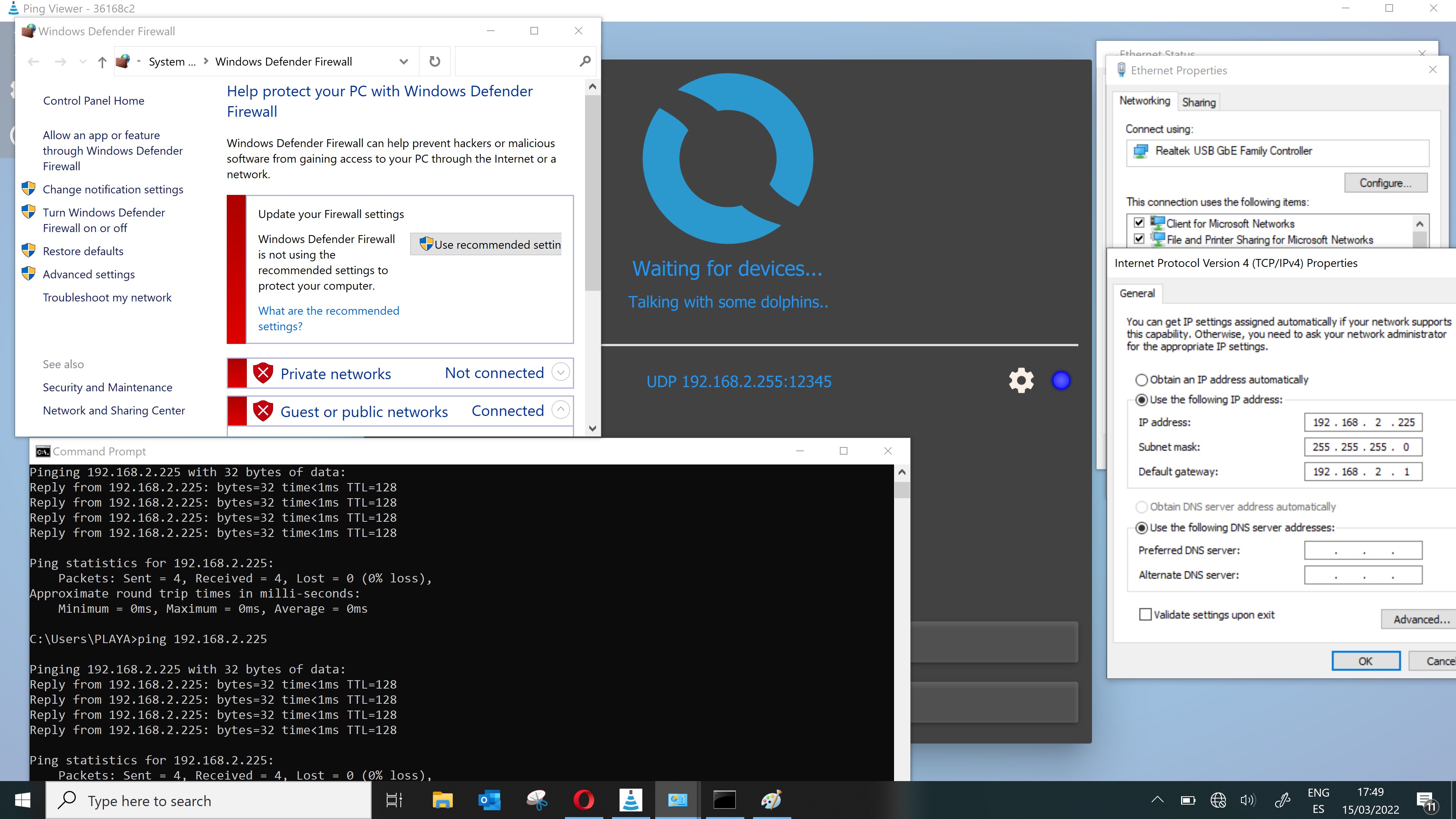

Hello Elliot.
Thanks for the reply.
Please find attached some pictures showing the configuration. I can see it when pinging it, but not sure why the Pingviewer doesn´t allow me to access to the sonar, showing blue dot. The Sonar takes the fixed IP as you can see but not sure why cannot access.
  • With the firewall Off
  • CMD showing comms
  • Network card IP settings with subnet 255.255.0.0 and tried also 255.255.255.0
Let me know your thoughts.

Can you try setting 192.168.2.1 for your computer - the subnet mask should be 255.255.255.0, and the default gateway can be left blank (from our Software Setup Guide):
And then try setting the Ping360 static IP to 192.168.2.4?
If I remember correctly, xxx.yyy.zzz.255 is a broadcast address, so setting that could be causing issues.
