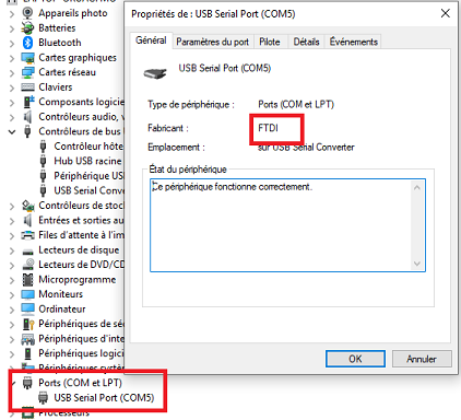

When I connect the ping to the USB port, in the device manager, I have:
So it seems that the USB port is correct.

Hi,
In your last picture, please go under the serial device Properties → Details → Property → Service and provide the value of this property.
