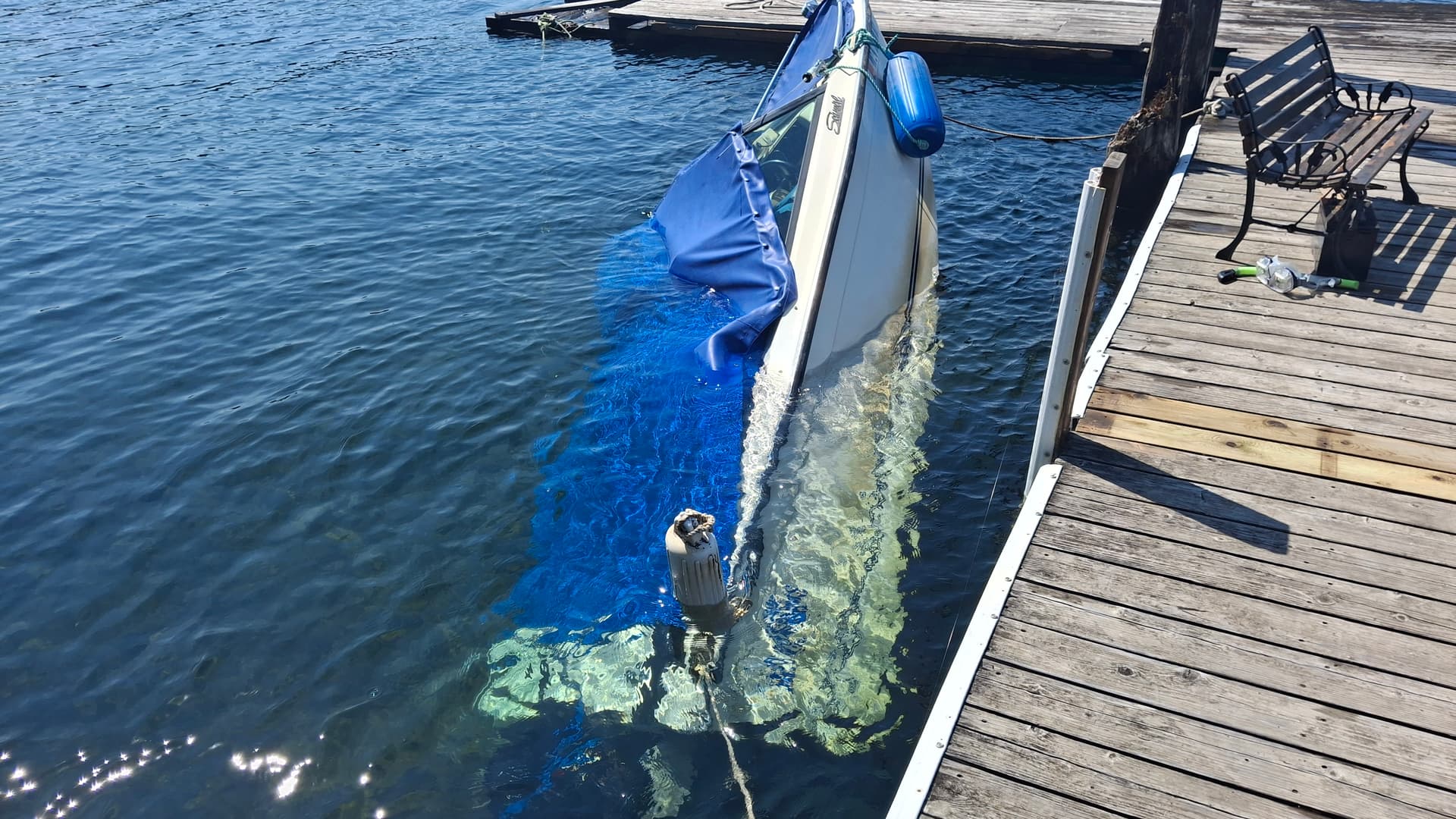

Unfortunately, I didn’t get a chance to test it last weekend because our boat sank. Definitely wasn’t the shipwreck I was expecting to look at. We did get it back up with a chain hoist and 2 come-alongs, and both the boat engine and the outboard are running again. Might possibly take the boat back out to the lake this weekend.

Oof, glad you managed to recover some criticals at least…
Hope you manage to get that weekend trip in :slight_smile:
