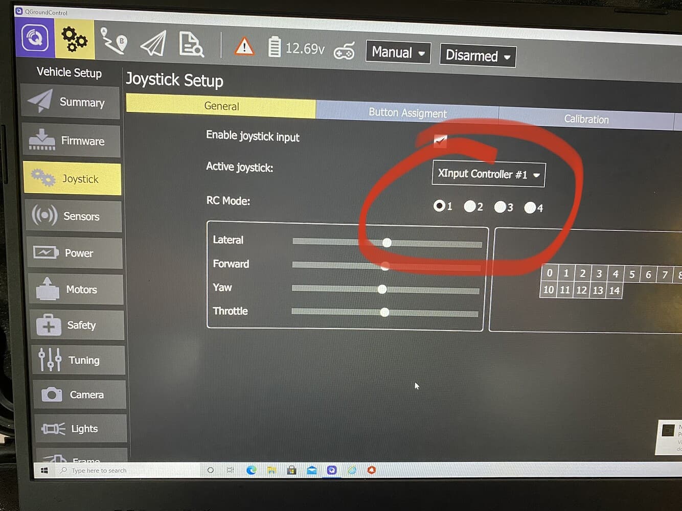

The vehicle was in water and could freely move, it shouldn’t have had a issue with the tether. It was negatively boyant, would this be an issue? The right joystick did forward, back, left strafe and right strafe. This is what makes me think it could be configured to the wrong type of vehicle or similar. No, I was searching for options for ascent and descent on the controller, which did not exist in QGroundControl, where you said it should have been on the right joystick.
Hi @bluepajamaz -
Yes, the vehicle needs to be floating not negative in order to sense the motion most reliably.
You may have set your controller RC mode differently than “mode 3” based on the behavior you describe - check your joystick configuration. This is where the mapping of joystick axis to motion occurs. Vertical motion is labeled “throttle” as this is typical nomenclature for a flying vehicle, that requires throttle to hover!
