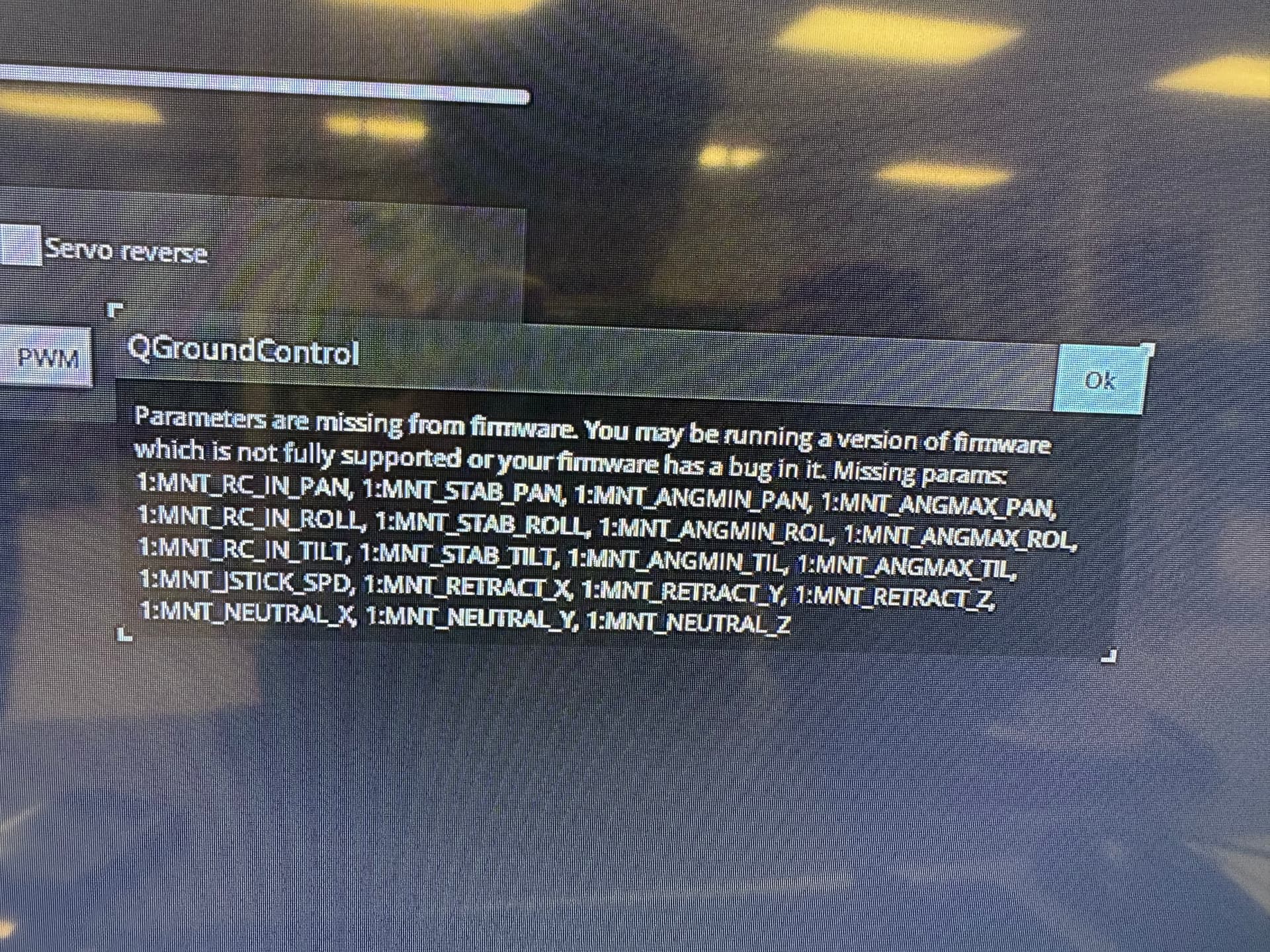

First I want to clarify that I am new to BlueRobotics and this is my first time using this software. I was able to get the motors armed and moving on the QGroundControl as well as the video streaming. Now I am trying to get the servo tilt for the camera working but it sends a message that I am missing parameters. I am not sure how to set those parameters or what values I should set them as. Also from reading other posts I couldn’t find the parameters they said were important such as BRD_PWM_Count.
Here is a picture of the error

QGroundControl is version v4.4.3,
BlueOS 1.3.1,
and I updated yesterday from Ardupilot 4.5.1 to 4.5.2

Each of those things didn’t solve the problem, but I have question on whether another factor is important for solving the problem. On both QGroundcontrol and BlueOS there is an option to save or download parameters. I was wondering if there was a way to download the missing parameters or if I could download the parameters from somebody who doesn’t have the error
Hi @BlakeC and @hydro81
Unfortunately, there is no solution! This is a nuisance error, and requires an update to QGround Control to resolve from what I understand… it is asking the autopilot for things it doesn’t know the autopilot doesn’t have - it shouldn’t affect normal operation!
If you find this annoying, you may enjoy Cockpit, where Blue Robotics has been focusing its efforts on improving the ROV control experience. It’s fully open source, and super configurable!
