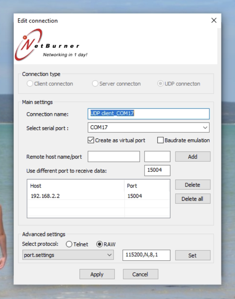

  8. On your computer open up NetBurner Virtual COM Port
  9. Create a virtual UDP comm port

  11. Go to Receiver. Set Connection to COM17, Baudrate: 57600

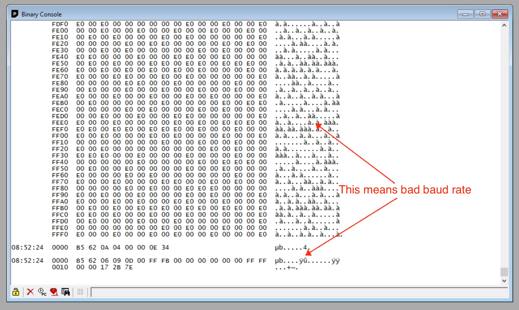

  12. From View open Binary Console and then Configuration
  13. You should see readable data in the right of the Binary Console. If you see garbled data on the right like the image below, the baud rate is incorrect. Go back and try another.

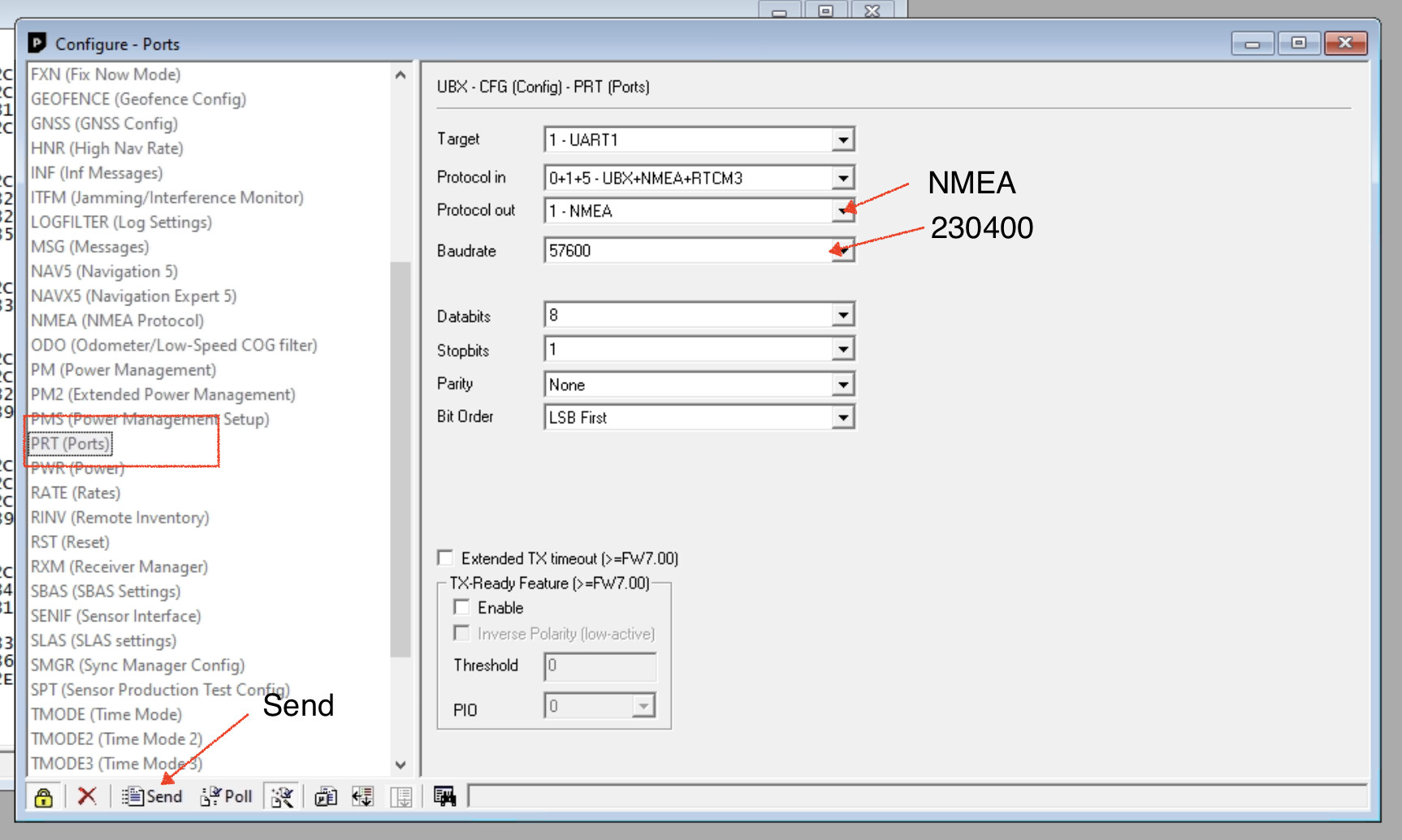

  14. In Configuration View, look for PRT. Set Protocol out to 1 - NMEA and Baud to 230400. Then click Send at the bottom.
  15. Set the Baud rate in Receiver to 230400. Click Hot restart.
