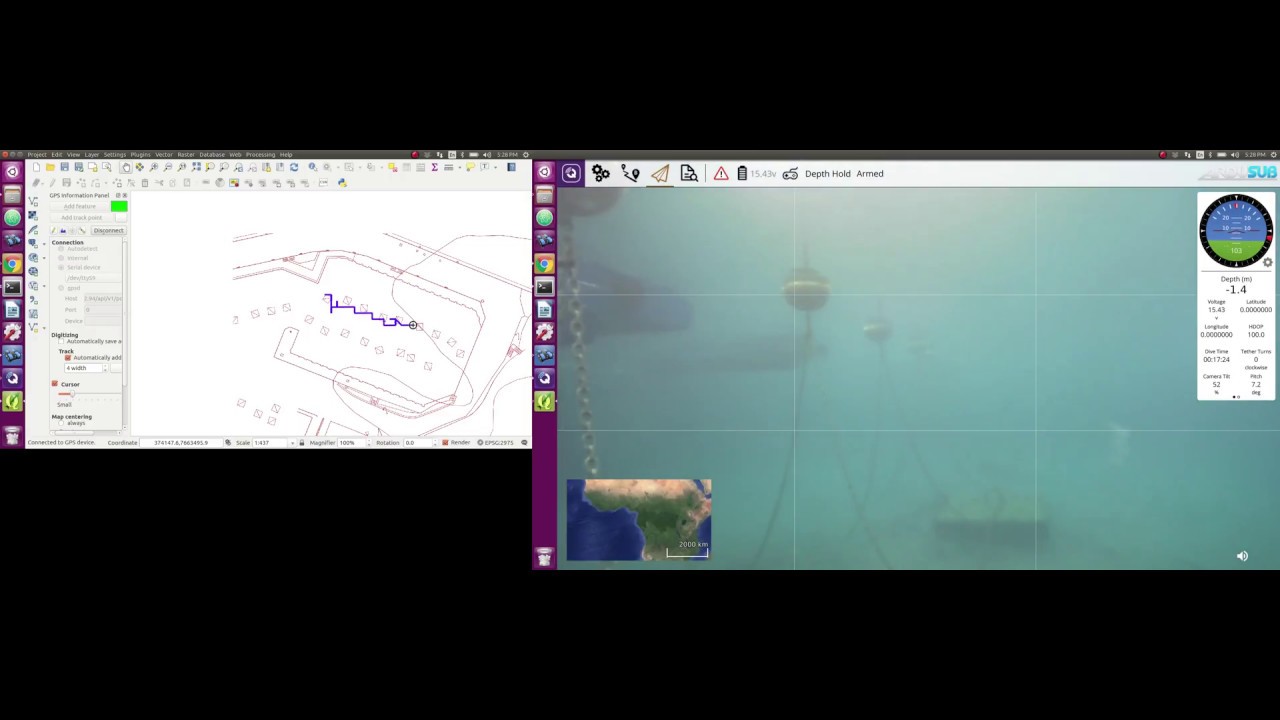

I must soon realize a georeferenced subsea inspection (I have a BR2 + waterlinked) for a client who requires a single deliverable with video + in parallel position of the ROV on a georeferenced 2D drawing (depth and position of the ROV must be included on the video) + a separate logfile with videotime/position/depth.
What we have achieved until now with my colleague Alexis is to include the 2D drawing on Qgis and do a screenshot of both Qgis and Qground:
But this is not a very professional deliverable for our client (low quality video etc) and it seems difficult to realize the separate logfile required.
