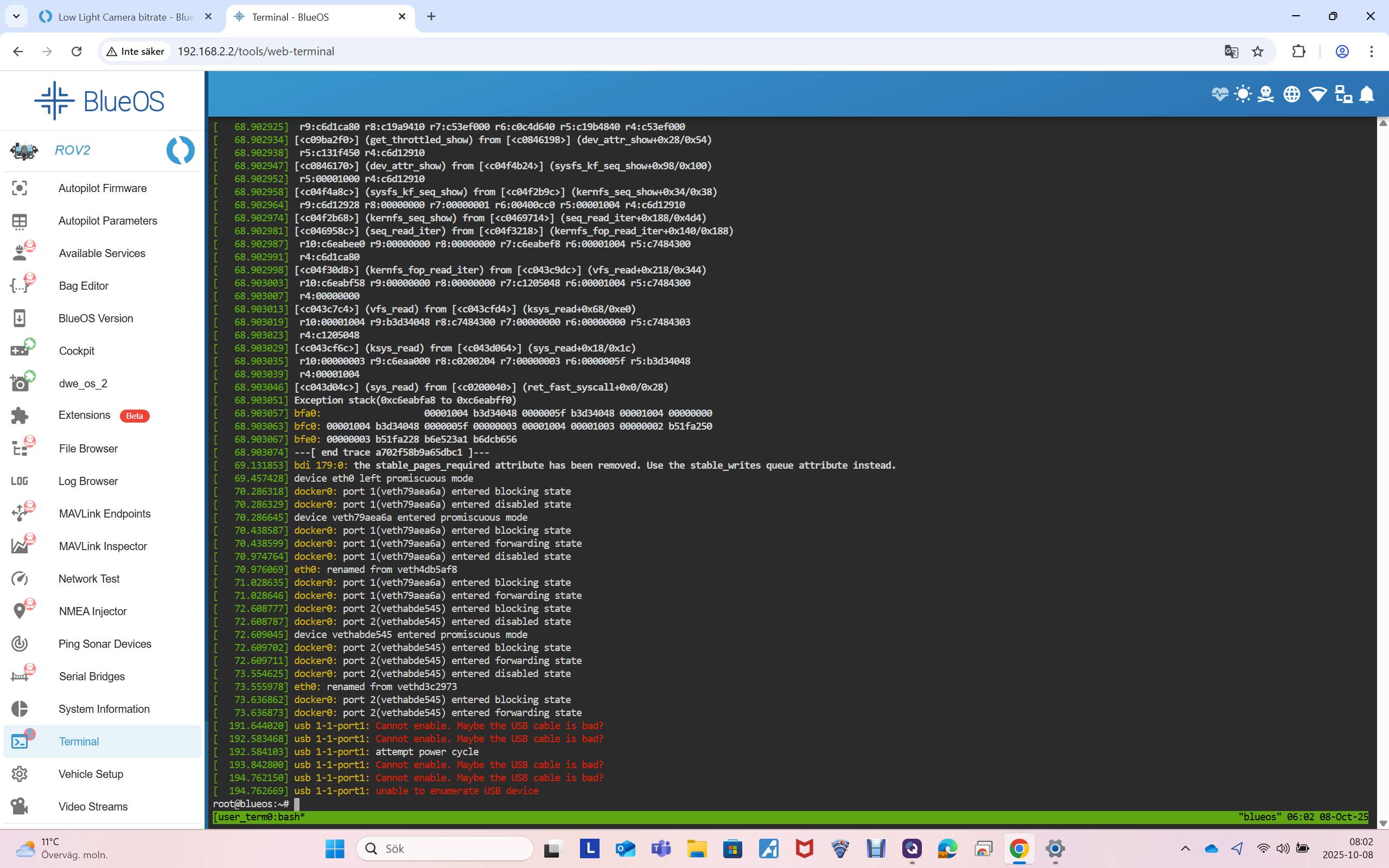

If a single camera isn’t being recognized on the BlueOS streams page, and you’re running stable 1.4.2, please navigate to the Terminal (in pirate mode), take the “red-pill”, and then type dmesg. Post a screenshot of what results!

I did as you said and will sen the picture from BlueOS

That screenshot shows the camera isn’t being recognized by the Raspberry Pi - Have you modified / extended the cable the camera came with at all? I assume your test with DWE’s “test program” was done on another computer? The Pi is considerably more sensitive to impedance than most devices, this could be the cause of your issue…. Can you share a picture of the USB cable going from the Pi to the WetLink Penetrator?
