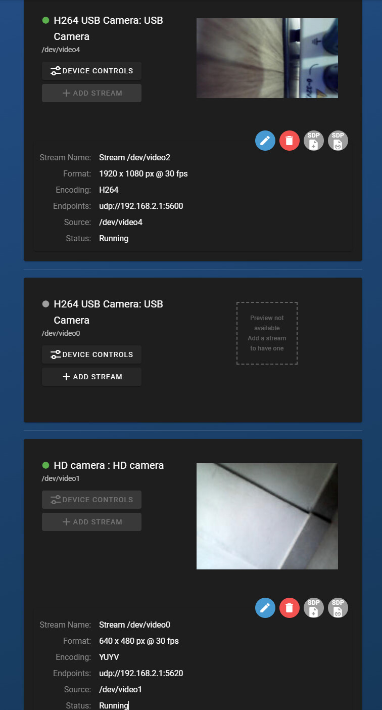

From your screenshot, your two streams are already set up and running - otherwise they wouldn’t both be marked as running, or have visible thumbnail images being pulled from the streams.
Hi @DanBRS -
Just to add on to what Eliot shared - the second stream you have configured is using YUYV encoding, which is an uncompressed format not supported by Cockpit or QGC! You’ll want to use a camera that has H264 output, and then everything just works.

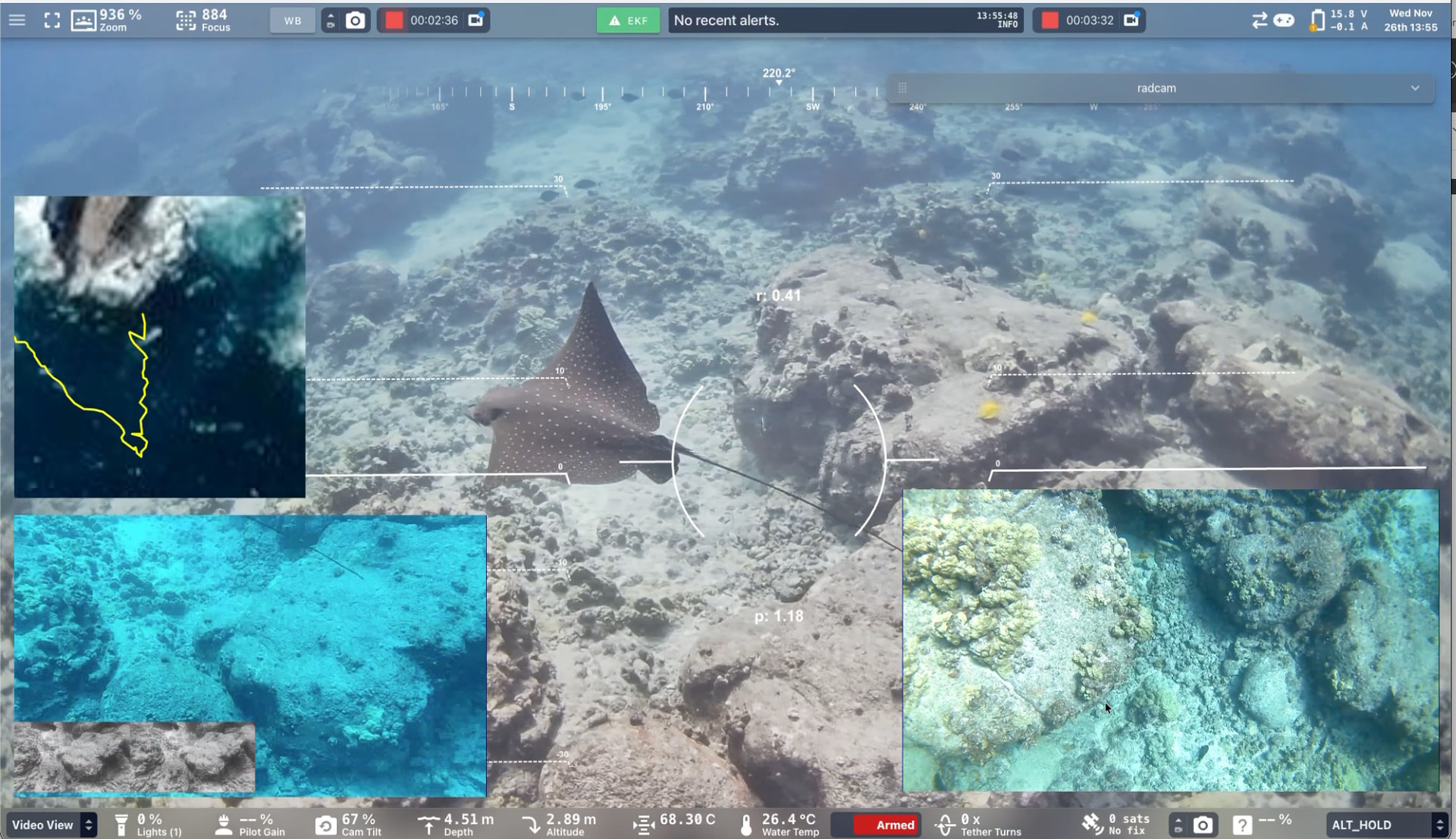

Here is a screenshot from some testing I did yesterday that illustrates that multiple streams work great!
