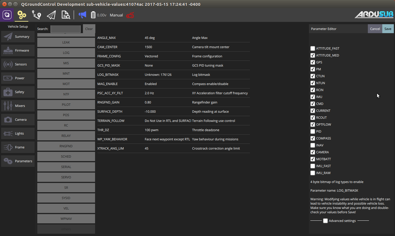

I can get the roll, pitch and yaw from ATT but I am not sure about throttle. CTNU (throttle and altitude information) has a throttle attribute but my dataflash is not recording it. The lable for CTNU is there in my dataflash but the actual data is not recorded during flight. Is there a way to enable this? I know mission planner allows us to choose which things to record but these options are not available when I plugin my pixhawk with ardusub flashed on it. Same goes with QGroundControl there is a parameter to enable recording dataflash but none to pick what gets recorded.
The parameter you are looking for is LOG_BITMASK, it doesn’t appear in the same category as the rest of the logging parameters.
RCIN will also write the input from the joystick, no RC receiver required.
