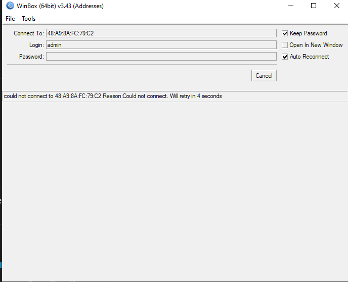

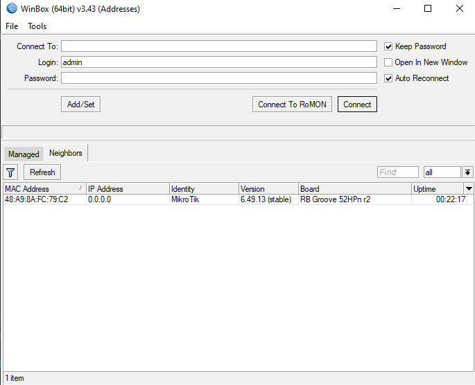

@tony-white Please help, I am experiencing a similar problem while trying to reset the BlueBoat’s router to factory settings and apply the configuration file in accordance with the zip manual. I could successfully reset the BaseStation through WinBox and could ping it on a laptop, no lags or any problem. When trying to reset the boat’s router, I could press on “Remove Configuration“ button in WinBox but it exited the further configuration menu. After that I kept trying to connect to the router via its mac address, its IP showing 0.0.0.0 and identity name being “Mikrotik“, but it wouldn’t connect at all. Oftentimes I am not even able to see the device on the list when connecting to the laptop (or it appears after a long wait time). I tried connecting both via the Ethernet adapter from the kit and via Ethernet port directly, didn’t observe any difference. I am now stuck and don’t know what to do.

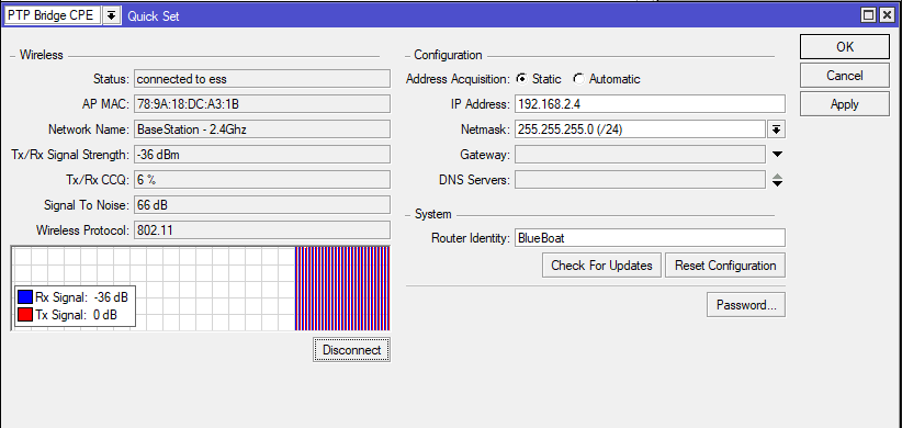

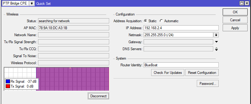

I rebooted my laptop and the starboard and could connect to the router and set the configuration file successfully. However, in the last step, the boat’s router connects to the base station but keeps disconnecting from it. On the base station side (192.168.2.3 WebFig window) I see the boat’s router connecting for a couple of seconds and then disappear, continuously.
Is my router on the boat faulty? What could be the problem here that makes it unstable?
Hi @Yermakhan -
Have you configured the BlueBoat radio at 192.168.2.4 to connect to the BaseStation at 192.168.2.3 with the correct password? I’ve only seen behavior like that when the password was set incorrectly…
Have you operated either radio with the antenna not connected?
