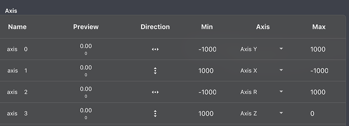

Cockpit joystick configuration can be a bit confusing, especially if you’re changing to RC Mode 1 from Mode 3 default.
The picture above details the default (mode 3) values for each axis - it is the vertical one that is different (Z) and so a bit confusing!
This screenshot was taken on the table view of the axis - you can also set the axis range in the visual view by clicking on a joystick in the picture of the gamepad.
Please share a screenshot of your table view of axis configuration if you still have issues after making adjustments!
