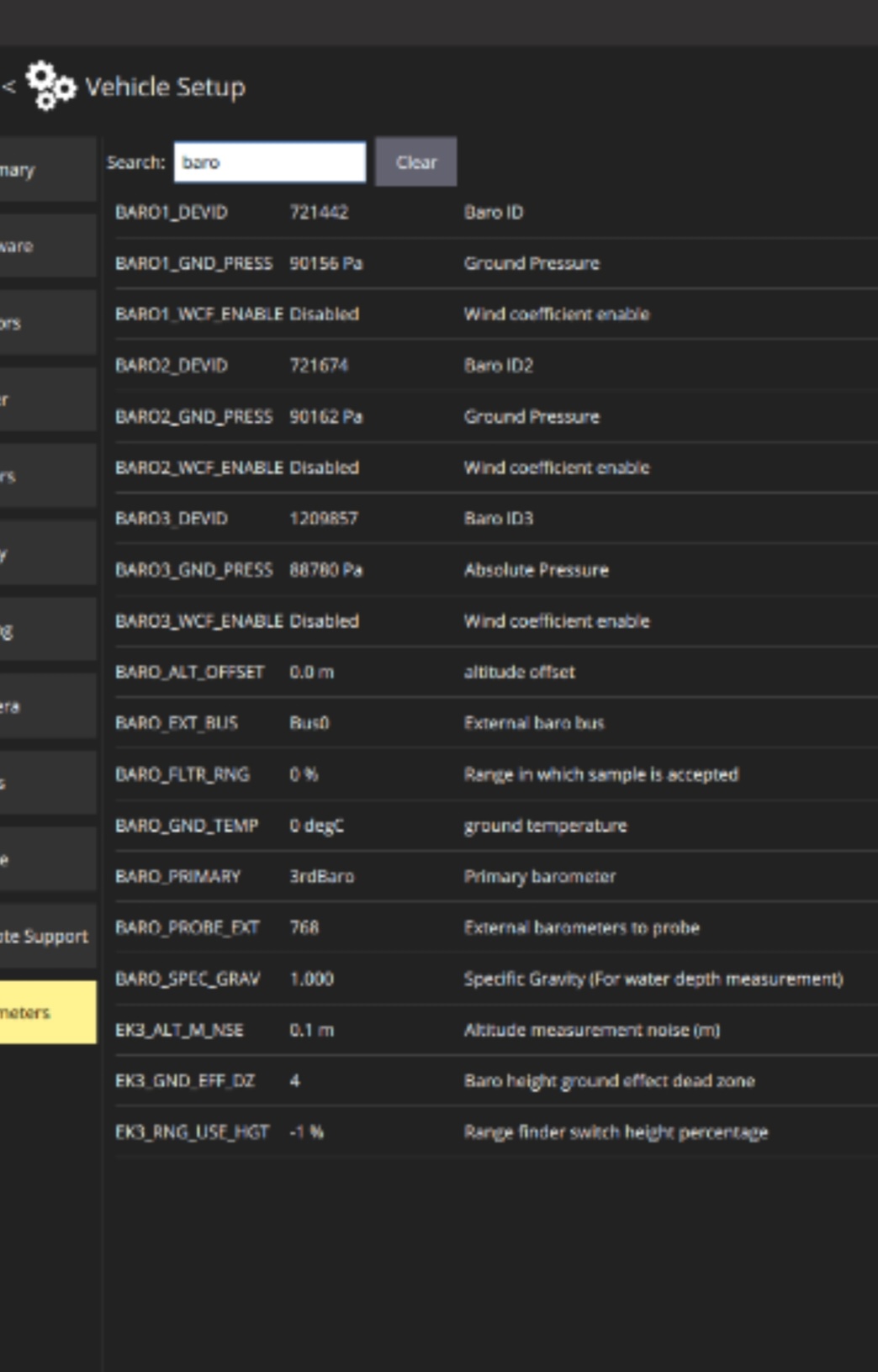

I’m using a Pixhawk Cube Orange+ with ArduSub 4.5.3, and I’ve connected an external DEGZ300 pressure sensor (MS5837-based) via I2C.
QGroundControl detects the sensor as BARO3_DEVID, and I’ve set BARO_PRIMARY to 3rdBaro, so it’s selected as the primary barometer.
However, I want to access the pressure data over MAVLink.
I receive SCALED_PRESSURE and SCALED_PRESSURE2 messages, but SCALED_PRESSURE3 is never published. Therefore, I cannot get the data from the external sensor.
How can I receive BARO3 data via MAVLink?
Is it possible to enable SCALED_PRESSURE3?
Or is there another way to access the external barometer’s data?
Thanks.
