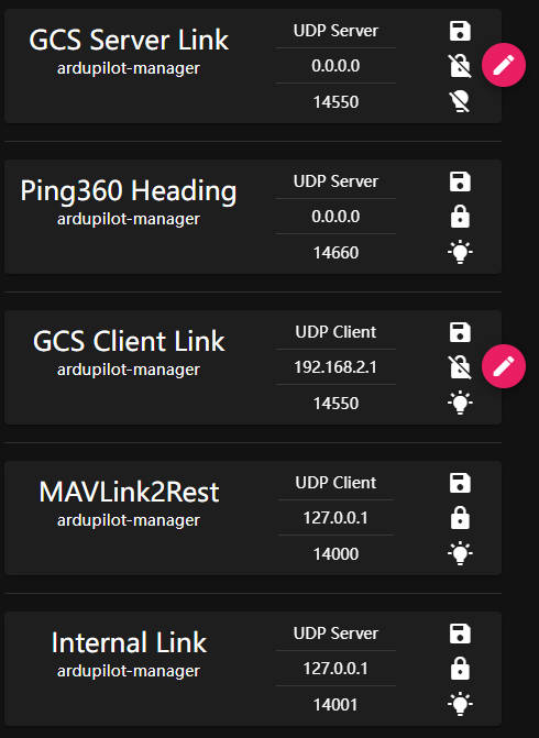

Thank you very much for your reply. I did according to your answer, but I still didn’t connect to QGC. I don’t know if I didn’t fully do what you said.
The specific situation is as follows: When I added the IP address of mavlink endpoints in blue OS, it was not automatically filled. I manually entered the IP address of the PC 192.168.2.1 and then clicked Create, but QGC did not connect to it
Hi @shawz -
Is 192.168.2.1 actually the address of your computer on the WiFi network that the system is connected to? I would have expected a DHCP address to be present if you’re using a WiFi router. Did 192.168.2.1 fill in automatically? This route does not need to be added a second time, as it is the default GCS IP address and so already exists…

I’ve forgotten if 192.168.2.1 was originally in endpoints, I typed it several times because there was no response
Hi @shawz -
It looks like your computer’s IP address is 192.168.2.101 - if you put that into the Mavlink Endpoint for IP/Device (it should have automatically been filled in), and save the endpoint, things should work!
It seems your router is configured to be 192.168.2.3, that’s fine, but with no device at .2.1 your endpoint is sending to an “empty” address!
