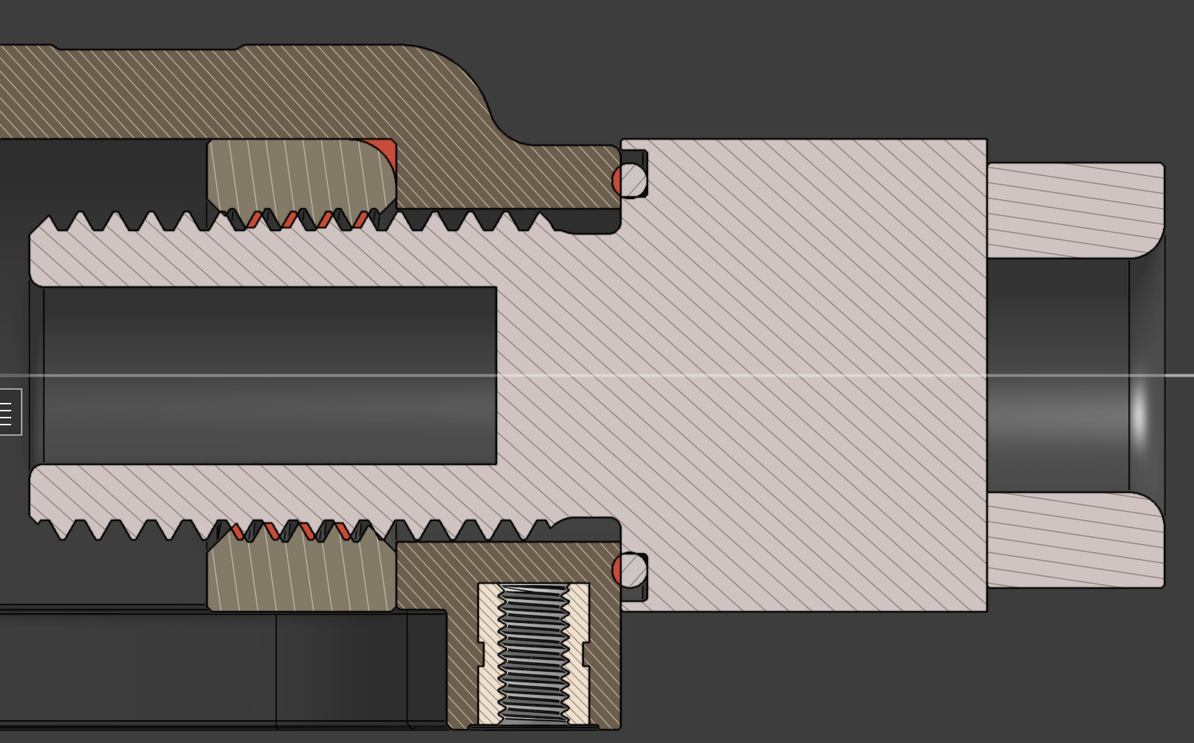

I checked with the 3D models available for both components - the M14 hole definitely fits in the splice kit, but the o-ring under the head of the bolt may be a touch to big to work well, especially if the hole isn’t drilled perfectly centered. It may work - if you try let us know how it goes!
Thanks Tony - Do you think there is clearance for the nut on the inside? Looks like it might be tight but I don’t know the dimensions.

I checked for you:
The nut maaaay fit - but it won’t go all the way into the corner, or freely rotate - the bolt would have to be spun in instead…
