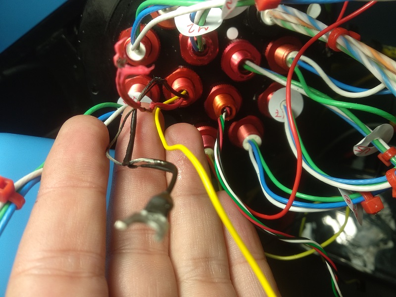

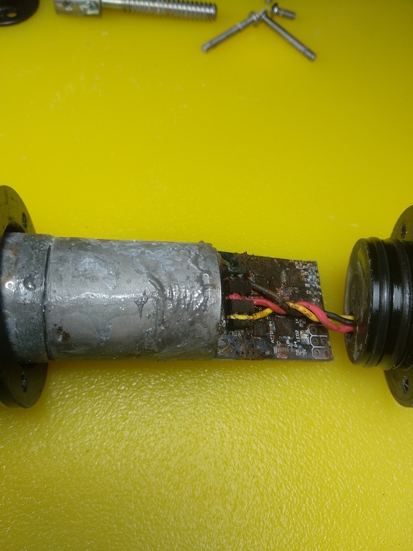

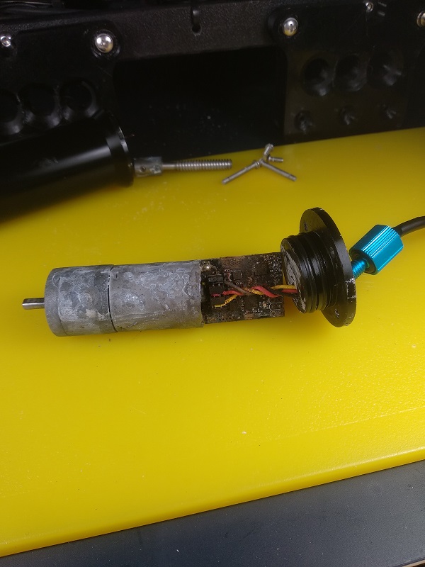

When we were back at office we started debugging so as to understand what the source of failure was. After a lot of hours of searching and testing we found the path of the water was through the gripper. We found the gripper full destroyed and the cable of gripper is not waterblock and we found the gripper’s penetrator was not sealed inside with marine epoxy…

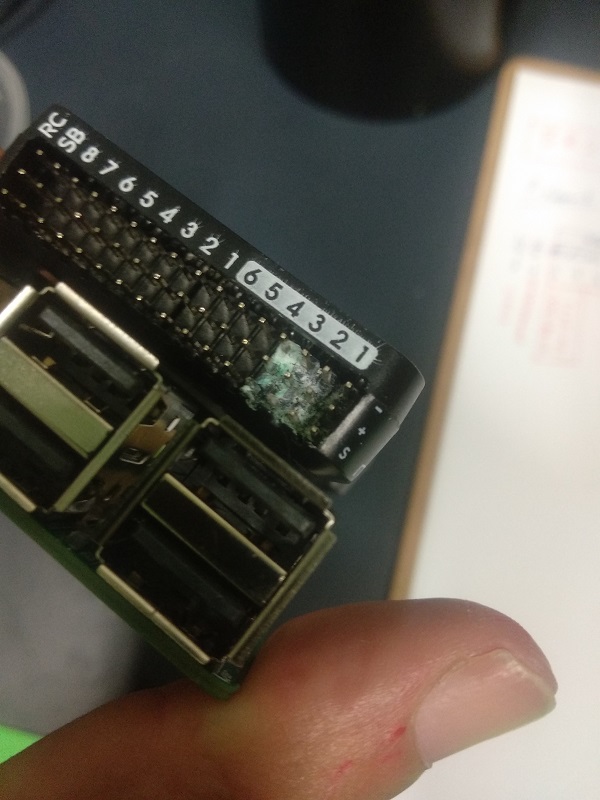

The final results were: a) a destroyed Pixhawx, b) a destroyed gripper and c) a destroyed ESC as you can see in the photos. We are re-assembling the system and we will test it next week (I hope everything else is ok and full functional).
