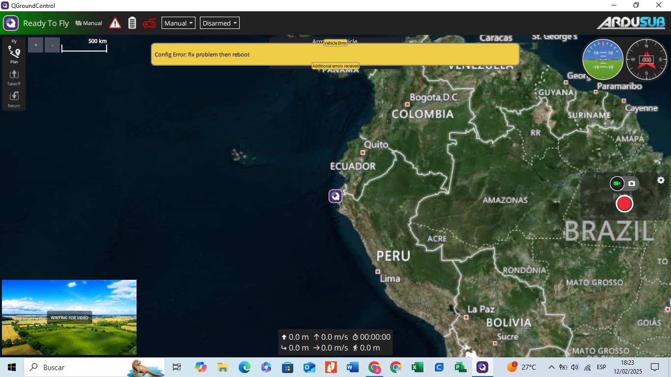

AND THIS IS MOMENTALLY APPEARING TO ME IN THE QGROUNDCONTROL. WHAT DOES IT MEAN? WHAT DO THESE ERRORS MEAN?

Are any LEDs coming on the Pi, Navigator, or Fathom-X? You should see 2 green LEDs on the Fathom-X for the tether connection - but your picture indicates you’re connecting via ethernet cable directly. Can you load BlueOS, or is the vehicle running older Companion software? It’s likely that you’ll need to replace the Pi, Pixhawk, and some of the ESCs, along with potentially the Fathom-X :disappointed_relieved:
