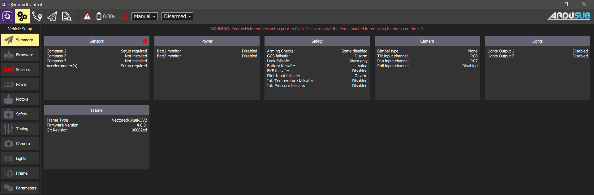

Hi there, Elliot. An update on the autopilot. We have recently purchased the Pixhawk 2.4.8 and it turns out that the web app recognizes it as a Pixhawk 1.
Ardusub has also been installed without any problems and it seems like it’s also recognized by QGC.
