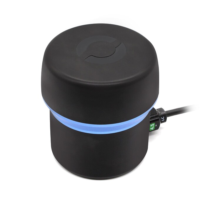

May I inquire if the P360 sonar can be installed vertically (with the sonar cable facing downward)? Additionally, would the mechanical vibrations generated by the robotic platform during operation potentially impact the sonar’s performance?
Hi @raccoon -
You can install the sonar in any orientation you’d like! The cable is always going to come from the WetLink penetrator in the side of the unit. Additionally, the scan direction is radially outwards from the top, so keep that in mind when mounting - you don’t want to block it, and likely want it rotating to scan horizontally rather than vertically?
