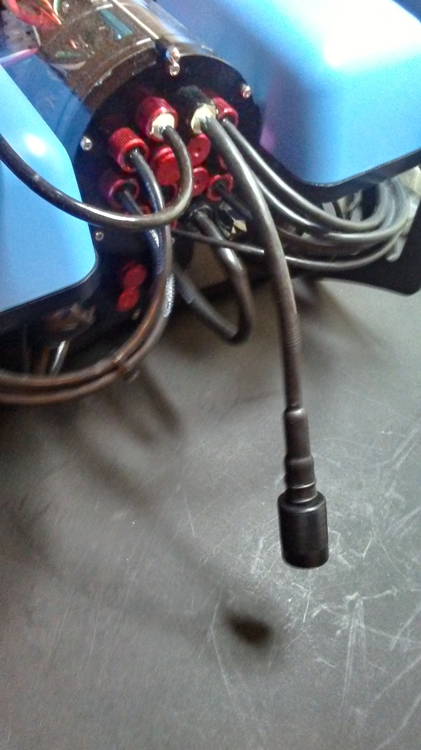

I haven’t had much time to work on it unfortunately, All I’ve done so far is to pot one of the connector pigtails into a B.R. penetrator (see photo). I haven’t quite decided to whether I’ll use the Scotchcast molds or use a section of shrink tubing as Rusty suggested.
What’s that other cable in the red penetrator next to it going to? ![]()
That goes to the Imagenex 852 sonar.
Hey Paul, that’s a good start. So the Seacon cable fit into the BR tether penetrator? I measured up the BR WTE endcap and surrounding penetrators and it will be a very tight fit for the flats on the nuts of the bulkhead (plus the existing hole would need to be milled out to 7/16"), so the pigtail arrangement you have would be great.
