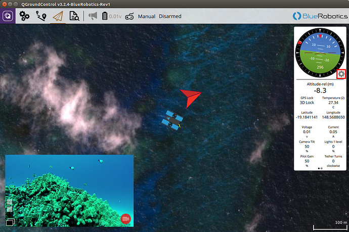

Do you have some pressure/temperature sensors already? Is this for a sensor deployment/installation or a diver, vehicle or what?
Hi Jacob,
Yes i’ve both on my BV2
Thank you
What is a BV2? Can you give us any information about the sensors?
The Bluerov2 sorry
Sensors are yours …pressure & temperature sensor
The temperature and depth may be displayed in QGC, click the small gear icon.
Yes thank you , i know it ,
I just want to create a graphic with depth and temperature … with a software…does it exist one ?
You can use Widgets->Analyze in QGC to graph live data. To graph logged data, see here.
