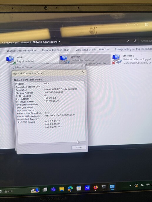

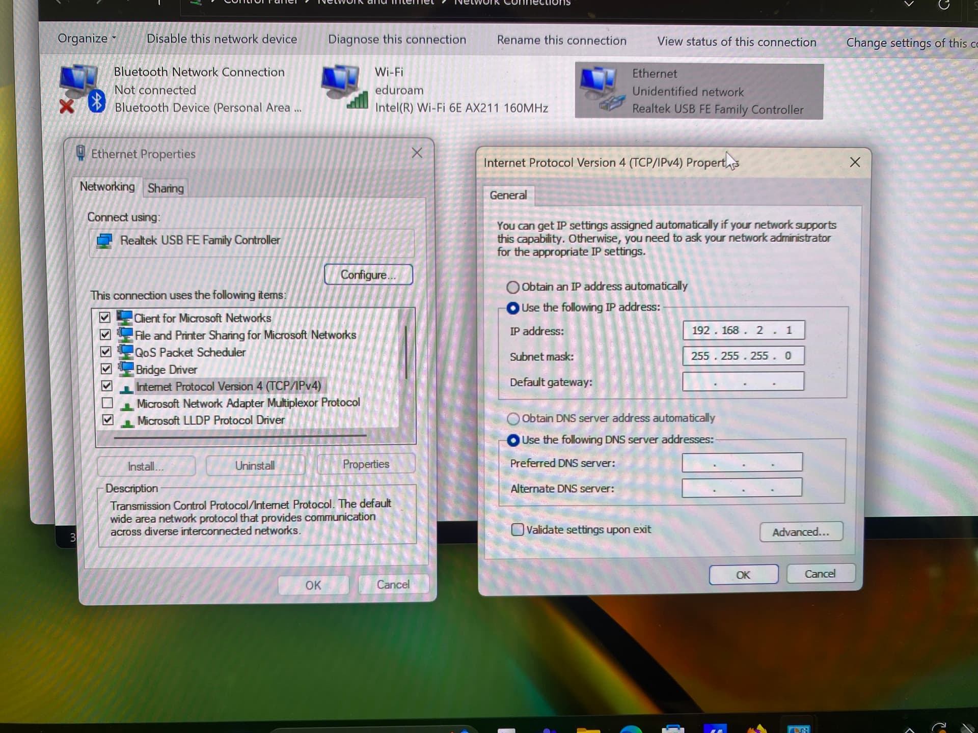

Hi @tony-white - I’ve attached some pictures of what we’re seeing regarding the network adapter. It seems like we are doing it correctly, but please let us know if something looks off.
The status for the fathom X ethernet did not change when the Pi ethernet was unplugged (see photos below). Is this what you meant by status? We’re not entirely sure if this what you were referring to.

Hi @Ingrid -
It looks like you have two network adapters present - are you sure you’re configuring the correct one? It’s also important they are both not configured to have the same IP address - only the one you’re using to connect to the ROV should be configured.
If you disconnect the FXTI with its internal USB to ethernet converter, this adapter should dissapear from the network adapters list, or at least show network cable unplugged graphic visible in your third second screenshot…
Hi @tony-white - okay, we just tried it again with the FXTI ethernet configured to the 192.168.2.1 IP address (we normally only have one ethernet connection to the computer). When unplugged, the network adapter disappeared from the list. Yesterday we also tried to ping with the Pi directly connected to the computer via ethernet with no luck (the FXTI was not plugged in at the time, so only one adapter was present). We are still not seeing lights on Pi ethernet port and only one green light on FXTI ethernet port.
