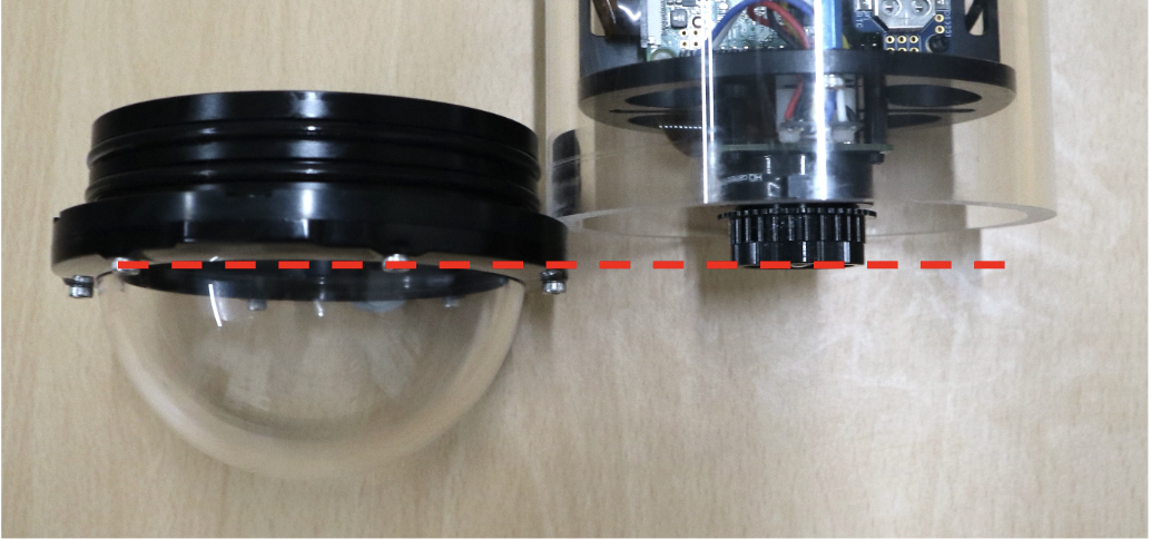

I ultimately was able to calibrate the focus with time-consuming trial and error: adjusting the manual focus, testing video underwater, and then retrieving and assessing quality of the video. The biggest learning was the importance of aligning the end of the camera lens with the base of the dome hemisphere. The image below, from Dunkley et al. (2023), shows this alignment. Other helpful resources are listed below.
