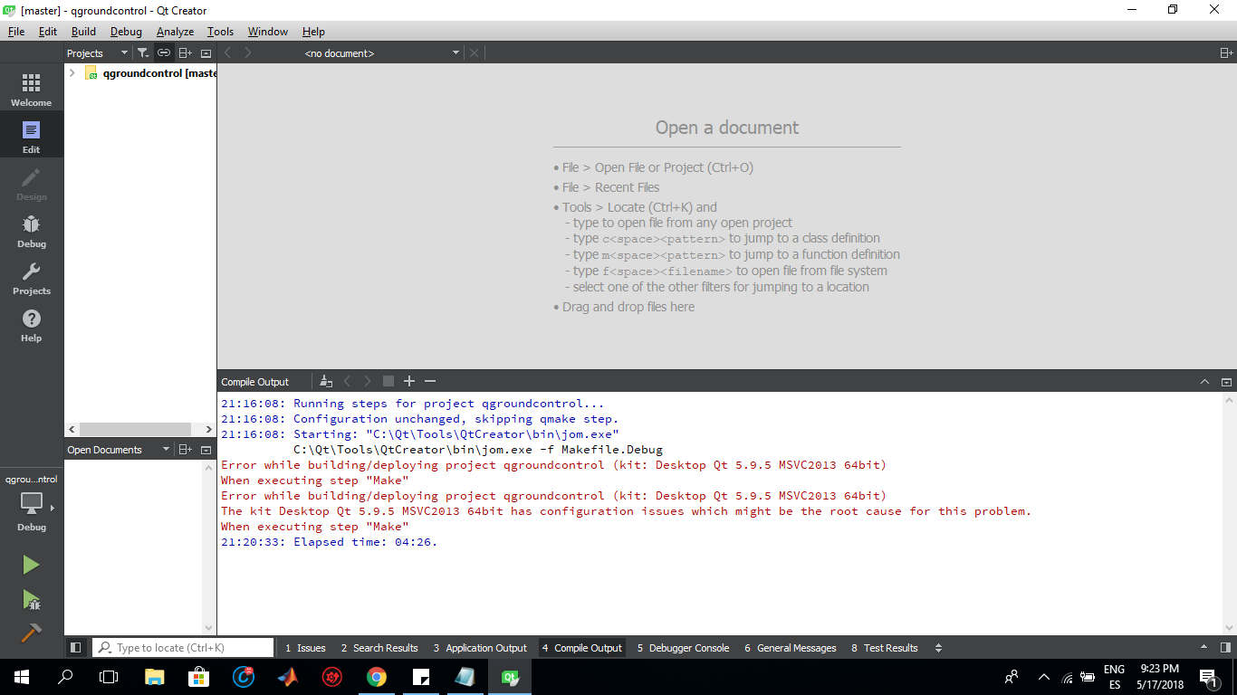

It seems that there are some things that I’m missing besides the video support, which I don’t really care about, although I don’t know what the rest of it means. Furthermore, there are some errors when I try to run the program, such as these:
First, you are running with the ARM (winrt_armv7_msvc2015) kit and not the x86.

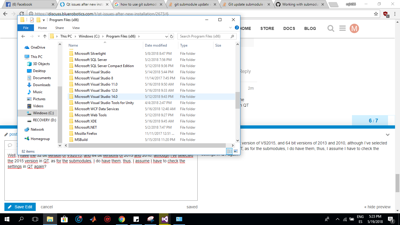

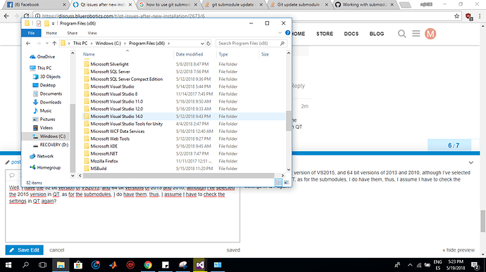

I have other versions of Visual Studio besides the 2015 32 bit, does that have anything to do with this? And how is this error fixed? It seems strange because you can use the 2015 version just fine.
Ah, and I don’t know if I needed to update the submodules since I did a new installation of the source code with git, so I skipped out on that step, although I’ve tried to use the git submodule update command and I get this output:
You can check the QGC project file QGCCommon.pri (line 49 of our last release version) that you need to use one of this versions:
win32-msvc2010 | win32-msvc2012 | win32-msvc2013 | win32-msvc2015
This error shows that the versions that you are using is not compatible.
To check if you have the submodules, use git submodules status, or check if the folders:
Well, I have the 32 bit version of VS2015, and 64 bit versions of 2013 and 2010, although I’ve selected the 2015 version in QT, as for the submodules, I do have them, thus, I assume I have to check the settings in QT again?
