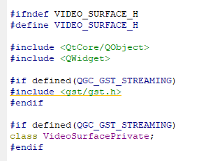

installed gstreamer 、mavlink_library_v2-master
You don’t need to install mavlink, only gstreamer.
error as follows:
This is not an error, this is part of the code.
Please, follow the instructions here about how to compile QGC.
