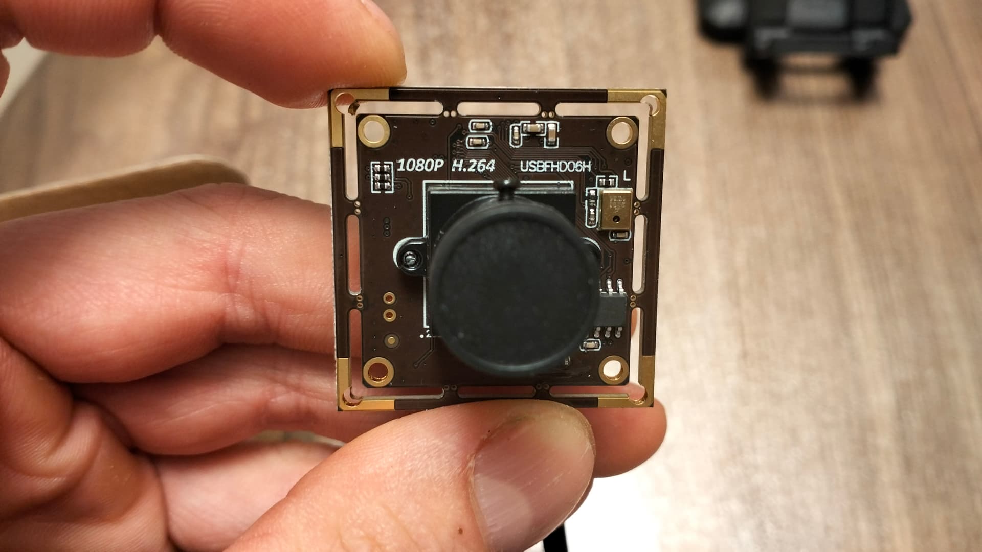

I’m using an elp-usbfhd06h-l28 camera with an H.264 output.I’ve also tried a different camera with an H.264 output, but the issue persists. Unfortunately, the website does not allow you to attach photos or videos.
