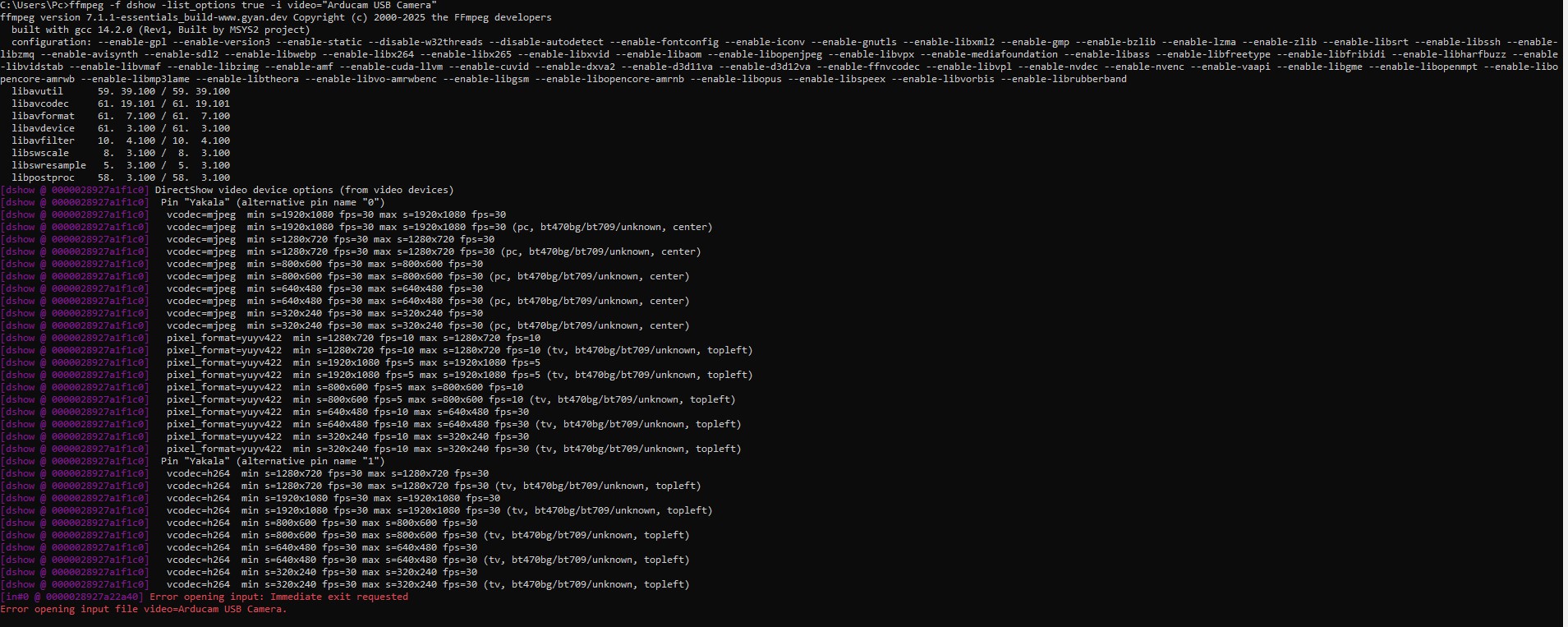

I have bought a USB camera and tried to connect it to my ROV.
It supports H.264 encoding.
But BlueOS did not detect it and redirect it to cockpit.
I needed to create a stream but there isn’t any H.264 option in decoding part.
I tried it with other encoding option but still no camera on the cockpit.
Could you please help me about it?
