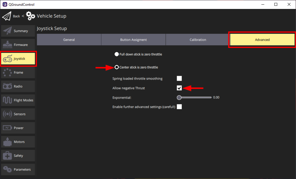

Thanx! But I have not such command… I can’t see the ‘joystick’ setup in my configuration…
