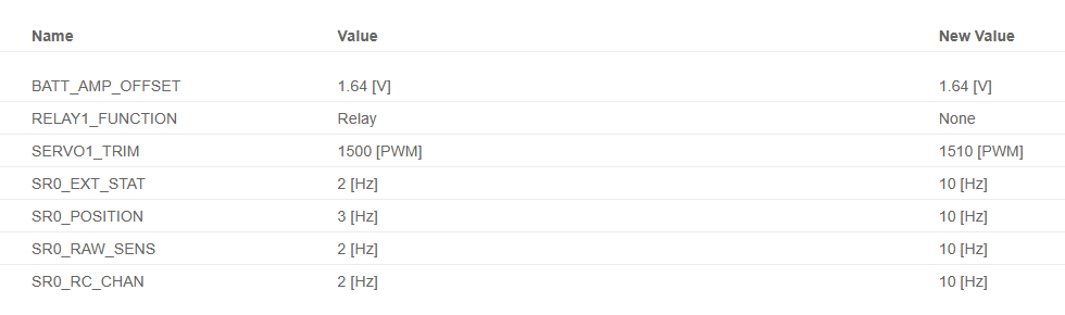

This is the full output when trying to load default parameters. Aside from SERVO1_TRIM we haven’t changed anything actively ourselves.

Those parameter changes are normal - the SR0 rates have been increased in the default parameters since the initial version your system shipped with, as well as the default relay configuration. It sounds like things are setup and working as expected, so let us know how it goes once in the water! If Auto / Acro / Guided / Loiter modes “go crazy” you’ll want to swap the ESC connectors at the navigator and verify your motor directions are still correct.
