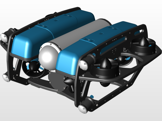

On our vehicles, we mount the thrusters on the interior of the frame, or have some sort of bumper guard around the thruster. You can see that here:
You can probably do the same thing with a short section of your PVC, just make it shorter than the thruster, and put it over the thruster like a hula hoop. Then, it will not affect the performance, because it will not interfere with the flow of water.
