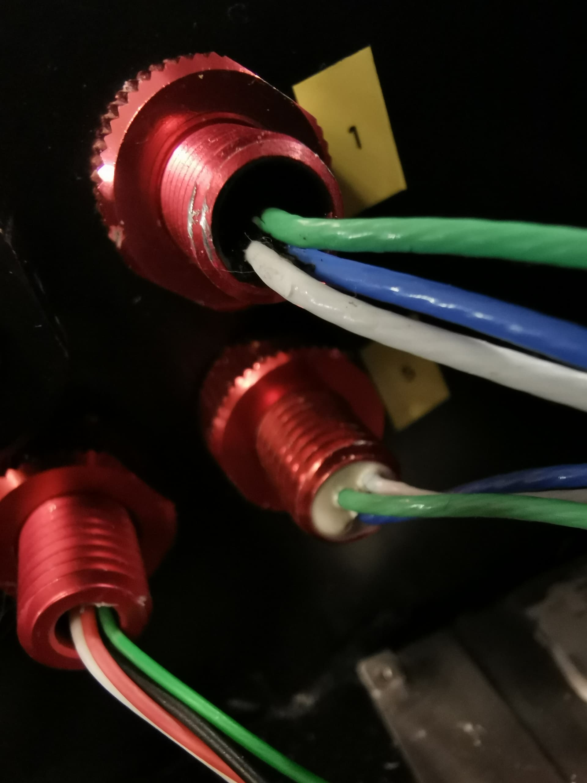

This is the penetrator that leaked, causing a lot of damage to to the electronics inside the casing:
These are a couple of penetrators that has not leaked (yet). Notice one of them has an extra white resin inside, wheras the other has the same lack of resin at the inner opening:
