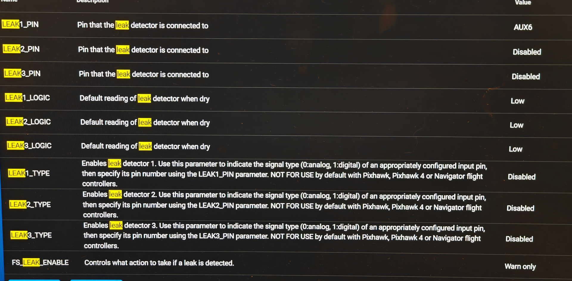

The leak sensor triggers the leak sensor board (steady red light), but never in the software, both BlueOS and QGC. If I disconnect the sensor from the board the red light goes away. None of the connectors are corroded or unclean. If I change the position of the sensor on the board it’s the same results.
I have the leak sensor board connected to Aux 6 on the Pixhawk, with the ground towards the top. Parameter is AUX6. Logic is Low. Leak1 Type is Disabled (analog or digital produced the same results).
I have tried Aux 5 on Pixhawk and software, same results. Reloaded parameters, same results. Downgraded Ardusub to 4.5.5, same results. Power cycled the ROV, same result.

My relevant parameters were:
Param Value Notes
FS_LEAK_ENABLE 1: Warn Only
LEAK1_PIN 55: Pixhawk AUX 6
LEAK1_LOGIC 0: Low
BRD_PWM_COUNT 4: Four PWMs → AUX 5/6 can be used for GPIO
Only needed for firmware before 4.5
SERVO14_FUNCTION 0: Disabled So the pin isn’t used as an output
If those were also your parameters then maybe there’s some other GPIO functionality configured on that pin (e.g. one of the relays), or there could be a problem with the pin itself (maybe try AUX 5 instead?).

Next: Installed 4.5.5 and parameters loaded successfully. LEAK1_PIN was AUX6, LEAK1_LOGIC was Low, and LEAK1_TYPE was Disabled. Leak sensor was not working. Next, tried your suggestions below:
Reboot didn’t work. Setting LEAK1_TYPE to Digital did work :ok_hand:Leak sensor is working now and Cockpit announced the leak warning. If I disconnect the leak sensor and re-connect there is no second leak warning, but I guess that’s probably by design. Anyway the dive would be aborted.
