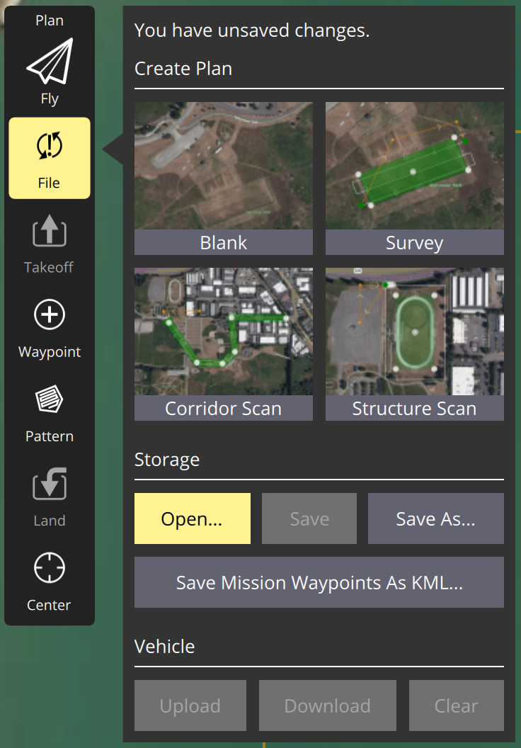

In the mission planning (“Plan”) view, you can
  1. Import a file

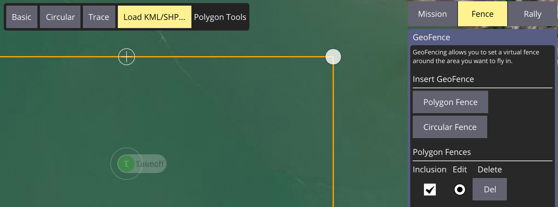

  2. Add a Polygon Fence, and load a KML
This thread may also be of interest.
The original developer of the functionality seems to have struggled with making that work cross-platform, so it likely isn’t supported (although it’s possible things have changed since that point).
