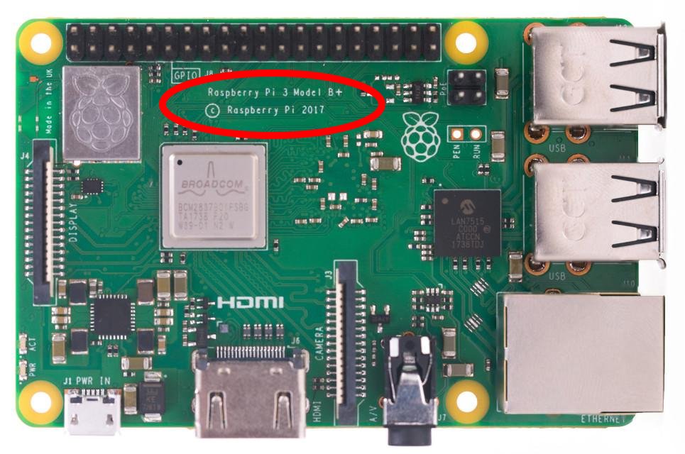

IS you Raspberry Pi the 3 B version? We don’t currently support the 3B+
I dont know the version of my raspberry…but what to do…should i replace by another model of raspberry ???
it was happened during my test seem i lost connection
it is written waiting vehicle connection
It is written in the raspberry itself:
If you bought it from Blue Robotics, it is the correct version.
