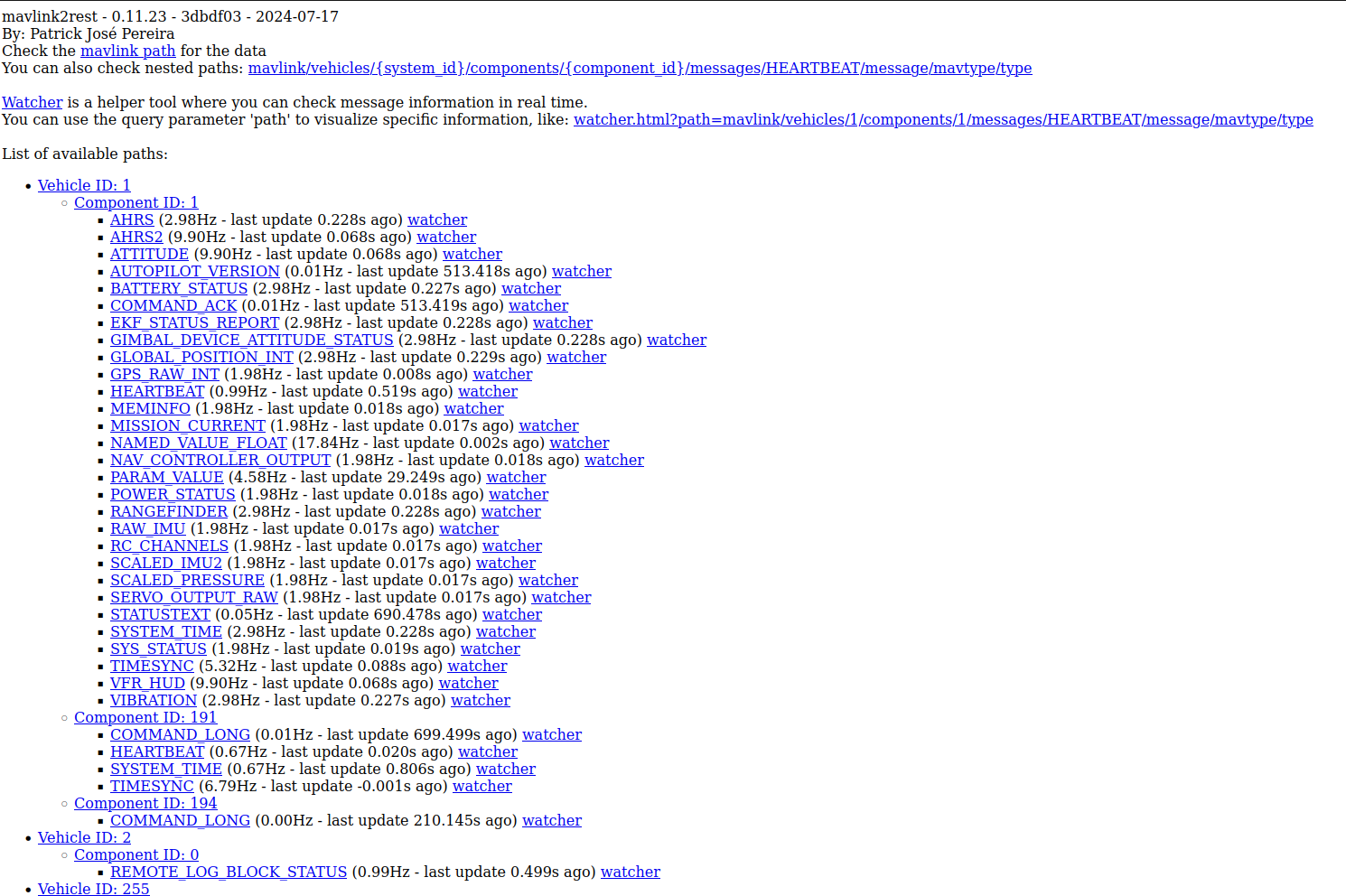

Well, you are correct about SCHED_LOOP_RATE parameter. However, I need to get the message of SCALED_IMU2 beetween 200 ~ 400 Hz, and apparently the SCHED_LOOP_RATE isn’t responsible of how fast the mavlink messages are sended out. On mavlink2rest, at this time, my SCALED_IMU2 is being output at 2 Hz frequency:

That’s correct, but it should be available to respond to queries that fast! Have you tried requesting it at your desired route via a script, rather than the Mavlink2Rest monitor there?

Hi @MIguel -
You can increase the rate of messages sent to ROS. Cockpit achieves this, using this method.
