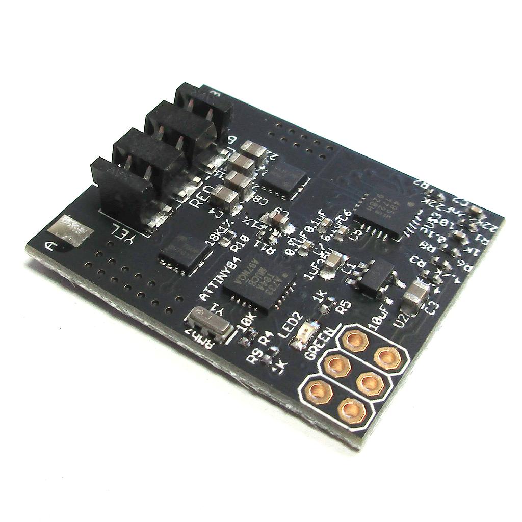

The Newton Subsea Gripper has a custom designed PCB with a custom firmware file that senses the current when the brushed motor stalls (stops).
The firmware has been adjusted so it still has enough strength to grip an object, but not enough to break fingers or tear the gripper apart. We have done a few thousand cycles in our tests.
Is this PCB open source? Can we obtain relevant documents for secondary development
Hi @Franck,
You can check the schematic in the firmware repository:
Thank you.This is exactly what i need.
